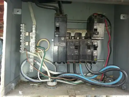

If you're going into a service panel, tie it into the bus-bar which has all the other ground wires. Here's a picture of a panel with two bus-bars. Sometimes there is one bus bar. Sometimes they carefully separate grounds from neutrals. Other times they don't, depending on the rules. Just Do what you see in your panel.
Those are all single breakers, you might have a tandem aka duplex, which crams 2 breakers into one space.
