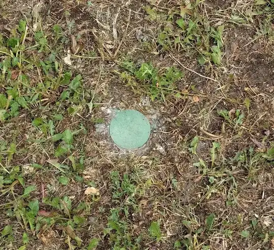

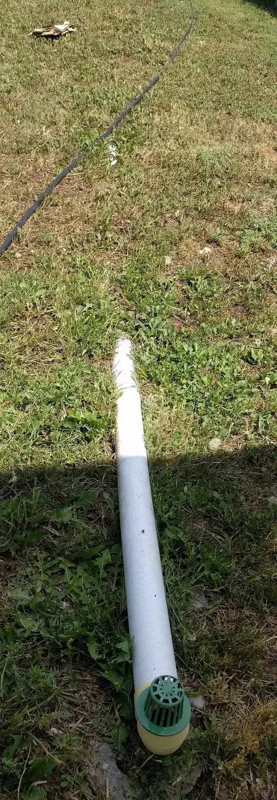

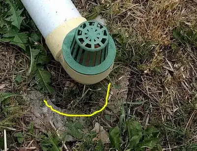

There's a plastic pipe with a vent cover in my back yard that runs to a green cap in the middle of the yard. What is this for? I don't have a septic tank.
pipe with vent cover
pipe cap

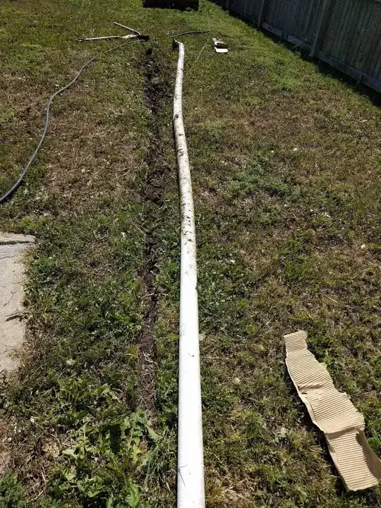

Update: this picture shows the entire length of the pipe that I'm aware of. The green cap from my second picture wasn't visible from this angle so I marked it with the piece of cardboard.
entire length

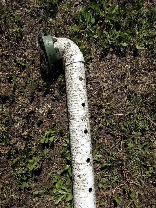

Based on everybody's comments, I felt comfortable digging it up. Here's the entire thing:
removed pipe
close up of pipe showing holes
Thanks for all the help everyone! Your comments/answers let me dig up this unused nuisance I've had to mow and trim around for far too long.

  • Whats the level like? Does the ground rise or fall along the length of the pipe? Are you in a temperate zone or a frost zone ? Looks like someone's half-arsed drainage system that was never done right.... its way too shallow for a start. Consider running water into it and see where that goes. – Criggie Jul 04 '16 at 00:51
  • Could be from an old pool with a center drainage system. – the_lotus Jul 04 '16 at 15:07
    @Criggie, the ground level is definitely lower at the cap than the vent. I live in Colorado. Running water through it does eventually make the cap pop up and let the water out. – Dennis Jul 04 '16 at 15:44
    Since you've dug it up you may want to hang onto it for a season or two - you may find a small lake develops in the shallow around the vent-end come springtime after the winter melt. If not, then it wasn't doing anything for you at all. If so, probably better just to get some backfill delivered and grade the lot properly. – J... Jul 05 '16 at 00:27

This could be part of a larger yard drainage system. It could let water from the screened end of the pipe drain out into some buried drain field. It could also drain onto a deep buried french drain construction consisting of a sizeable hole that was filled with crushed rock or similar.
The fact that the part of the pipe that has the screen is working its way out of the ground seems to imply that there is stress on the pipe from the end that is still buried. This could be due to settling at the buried end or the pipe was originally installed and buried by forcing it into the trench and then not covering it with enough soil. I bring this up because there is evidence that the filter screen end was buried at one time:

    Yeah, the opposite end seems to be one of these [NDS pop-up water emitters](http://www.ndspro.com/pop-up-emitters) for their drainage installations – Tim Stone Jul 04 '16 at 13:38

    Good call on the noise- I placed a small speaker in the vent and walked around- the only spot I can hear it is the green cap. If I'm not having any issues with drainage in the yard, is there any harm in removing entire assembly? – Dennis Jul 03 '16 at 21:19

It's an NDS Pro pop-up drainage emitter
http://www.ndspro.com/catalog/category/view/s/pop-up-emitters/id/227/
I took the approach of noticing the acronym on the cap, figuring out what company it was and seeing which of their products match.
