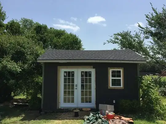

I have a 16x12 shed - the Home Depot variety - that came with the house when we moved in 4 years ago. I'm guessing the shed is about 10 years old.
The roof is sagging a few inches in the middle:
Also notice the eaves are bowed upward in the middle. To me, this indicates that, as the ridge 2x4 has sagged, the bottoms of the joists have pushed outward. Thus, the wall acts as a sort of fulcrum, and the part of the rafter that goes past the wall, supporting the eaves, gets lifted.
It also looks like the walls have bowed outward just a bit:enter image description here
(Please no comments about the horrible attempt at adding a soffit vent. It's getting replaced.)

Am I way off base here? If so, suggestions on alternate approaches?

Your plan is exactly right, except that you don't need such heavy-duty hardware to do the jacking/winching. Even a pair of motorcycle ratchet straps or a come-along is going to do the job, especially if you jack up the ridge board. I think it'll all move easier than you anticipate. Just make sure you have solid connections to the walls so you don't have any sudden surprises if something lets go. Maybe lag some loops to the top plates.
One or two rafter ties, well-attached, will prevent the problem from happening again. You could probably get away with keeping them a foot or so above the wall plates, too, if headroom is at a premium.
Good luck.
