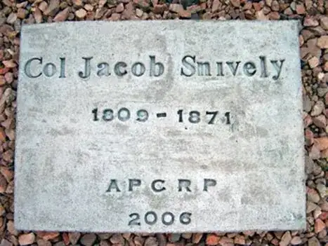

This DiY Headstone suggests high strength mortar mix.

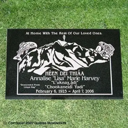

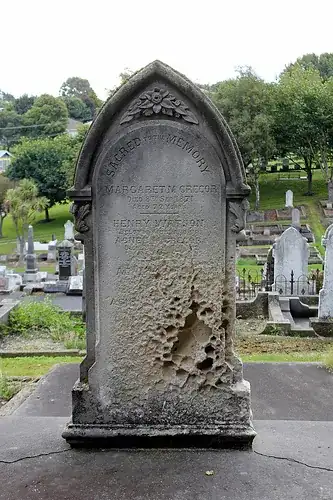

However, this is why you use granite:
I'd suggest Uba Tuba for its flakes:
Truly though, what I'd recommend, is having a real stone cut for you. They're not as expensive as I would've thought. Even a somewhat fancy one should be under a grand. But it doesn't really matter what we think... what does The Boss want?
This:
Or this:
Food for thought, regarding the fact that you're a metalsmith, if your only tool is a hammer...
If it needs to last, then it needs to be made out of granite.

I have found that using an inexpensive plastic container as a mold works quite well. Use painter's tape where writing and numbers will be and glue them to the tape, then trim the tape with razor knife close to the writing. (remember writing mus be backwards!) I prefer the fiberglass type concrete to the quickrete (rock and sand) type used for the two you see here. Use the quality concrete colorant and mix it very well before adding to the concrete. Take your time working all the air bubbles out without disturbing the foam letters and numbers. Set mold at proper angle and let dry for 20-30 days.
