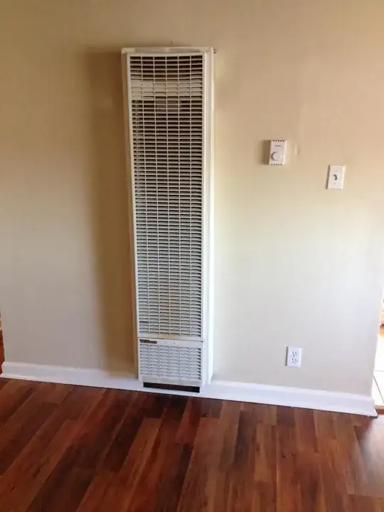

I moved into an apartment that has a wall-mounted heater that gets rather hot when turned on (see below). I have an inquisitive 1-year-old who already likes to climb up on the unit (luckily not while it's been on). I am wary about putting something directly surrounding the unit, both because it would block the heat and because it might be a fire-hazard.
Does anyone have suggestions on how to properly protect the unit from my child (and vice-versa!) without creating further issues? I cannot remove the unit or do major construction, as this is a rented apartment.

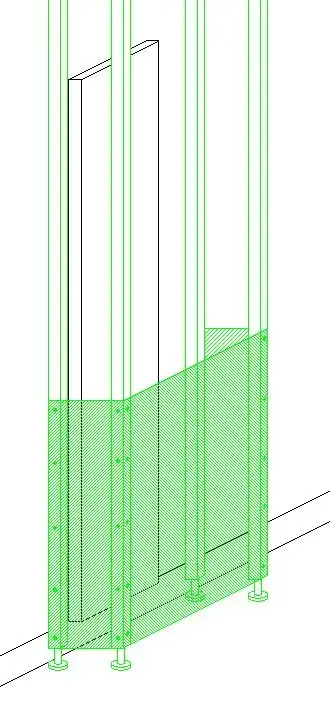

Search or shop for tension pole room divider for a solution that a child is unlikely to be able to move or tip over.
If you want to do it yourself then you can first install four tension poles in a small rectangle and then screw or clamp three sections of plastic or metal screen to make a box-shaped barrier. All your screws or other fasteners go into the poles and nothing goes into the walls.
Four tension poles installed around heater.
four tension poles
Three pierced metal screens screwed into the tension poles.
Add trim pieces over the screws to improve the appearance.
This can stay in place until you, or your youngest, move out.

  • Your illustration has the poles rather close to the unit. Wouldn't the metal screens also get rather hot? – magicker72 Jul 26 '16 at 16:10
  • The wall heater is convective rather than radiant. The inflow of air near the bottom of the heater will keep the screens cooler than the heater. - You should experiment with freestanding playpen segments to determine the comfortable distances for your heater and your climate. - Then afterwards, you should post your results here. – A. I. Breveleri Jul 26 '16 at 16:16
