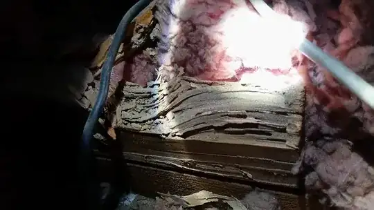

I am under contract on a house in AZ. There is obvious termite damage. The termite inspector found half a dozen spots (in rooms that hadn't been painted recently) near ceiling and top of walls where tubes where showing thru drywall. And, there's this in about 5 spots in the attic, mostly on top 1/3rd of horizontal 2x6s (that I could find easily):
...and this sporadically around fascia board. It looks like some fascia board was replaced and some wasn't. All of it was freshly painted and caulked. But, much (about half), you could easily break with your hands due to termites.
and caulked over...
My dilemma is obvious. My issue though, is that no one I hire seems willing to say anything other than: "This house had termites recently." --- well, you don't say?! Thanks for that!
How does one determine / asses the actual damage on a house that's had termites? Should I get another company that does the infrared imaging? Let's say I want to sell this house in 3 years. I'm confident I can repair visible damage, like fascia boards and I know the approximate cost. I want to know is there stud damage? Is the attic considered unstable at this point? How much of an issue is this and how often will it be an issue on future resale? Is it going to be like selling a meth home?

  • I'm figuring worst case scenario: Replace fascia board. Sister 2 trusses. Replace the interior non-load bearing wall underneath effected trusses (maybe, if it needs it, have to remove drywall to know). I talked the seller down 20% more than what I'd need to cover that work, assuming that's all I have to do. That's just based on damage I can see. I guess my bigger concern is: What I can't see? And, even if I do all that, am I going to have a hard time selling it when an inspector finds a sistered truss? – maplemale Jul 26 '16 at 18:03

How do you assess termite damage. You do it yourself. That is fine that you had someone help. I would go around the house with a fine tooth comb and document any kind of wood damage, any kind of paint damage, any sagging or structural issues. Everything should be attributed to termites.
So the main assessment is centered around if the termite damage is on the outside of the house - most houses are like this or is it pervasive through the whole house. You really need to spend a good deal of time in the attic (trusses, floor beams, and plywood sheathing under roofing) and in the basement looking at the structure. Framing and cosmetic things on the outside of the house can be fixed easily.
The next step is to get a quote from someone that can come in and fix everything on the outside, drywall and simple framing. Double that quote and take that off the price of the house. Remember that home owner has to now disclose this damage to all new people who look at the house. Mention this to them and use it as a negotiation technique.
