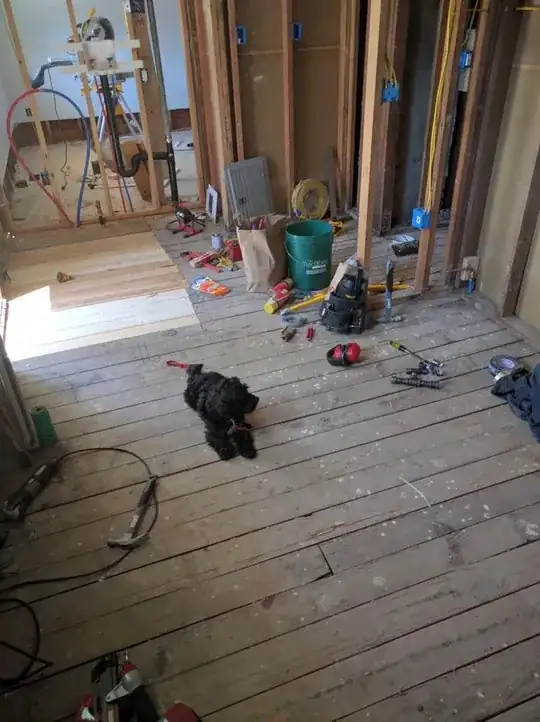

So my house has 2x6 car decking/tongue and groove/whatever-you-want-to-call-it subfloor that I am going to tile over, both in the kitchen and the bathroom. The rest of the floors are 3/4" oak as you can see in the pictures.
Underneath the subfloor is post and beam construction--4x8 beams about anywhere from 3-5' apart from one another (3' from the outside wall, then 5' thereafter). So the 2x6s span from 3-5 feet at a time.
There are two spots that I replaced some old rotted sections of the T&G which you'll notice in the pictures below. The older sections of subfloor were a bit springy in spots so I nailed some 2x4s flat from below, putting a nail into each piece of 2x6 along the way. This stiffened them up considerably and there's hardly any give to them anymore.
My question is how should I go about laying tile over this? I have the 3/4" wood floor to tie into so I don't want to go too crazy with additional underlayment.
From some initial research, it seems my best option might be to go with a layer of 1/2" plywood screwed to subfloor, then thinset/screw some 1/4" concrete backer, then thinset/tile. If I start with ply on the subfloor, do I need to use tar paper underneath that or should I use some self-leveler before laying down the ply (or do you do this on top of the plywood?).

  • Did you end up using a vapor barrier between the plywood and the 2x6's? – bigmike7801 Sep 30 '16 at 15:16
  • I didn't. Tried to prep the 2x6 as well as I could with self leveler in some spots and planing down other spots. Then I used liquid nails and 1/2" ply screwed down to the 2x6, then 1/4" backer board thinset and screwed to the ply. Then taped/thinset the seams of the backer board. Made it solid as hell and mostly flat/level. My taping job was not the best so I had to grind down a few high spots at the seams. – tbox Sep 30 '16 at 15:26
  • Part of the structural code states the equivalence of using ply to a vapor barrier. I'm on my phone so I can't look it up right now, but I think it's due to the glue in the ply. So you can skip the vapor barrier if using ply underlayment in some cases, though its always better to use a vapor barrier anyway. I skipped it because I used the liquid nails and needed a good surface for it to bond to – tbox Sep 30 '16 at 15:28
  • Thanks for the tips. I feel like I'm looking at pictures of my house when looking at yours. I'm in the Pacific Northwest and my house was built in 72. My biggest problem is that I can't get underneath my house to add any floor joists so I'm hoping that the way it currently is will be ok. – bigmike7801 Sep 30 '16 at 15:56
  • No problem. I'm in the PNW too (Oregon). House is mid 50's ranch. Here's a vapor permeability rating chart: http://buildingscience.com.678elmp02.blackmesh.com/sites/default/files/migrate/jpg/Vapor_Permeance_Chart_rev.jpg Plywood is even less permeable than tar paper so it sounds like you'd be adding an unnecessary step by doing both. If you make a hole in your floor like I did, you can get under there easily :) – tbox Sep 30 '16 at 17:02
  • Yup, I'm just north of you in Vancouver, WA. What part of Portland are you in if you don't mind me asking? – bigmike7801 Sep 30 '16 at 19:24

I quite literally did this exact same thing a few years ago.
First ensure that all of your structural posts have support beneath the house to foundation.
Then I got decking screws and screwed the planks down everywhere they were already nailed.
Then I bought about 50 sheets of CCX ply and lots of subfloor glue. I glued and nailed ply over the entire floor using shanked dipped nails.
Now I had a very stout floor about 2" thick....
Ditra over that, tile over that.
