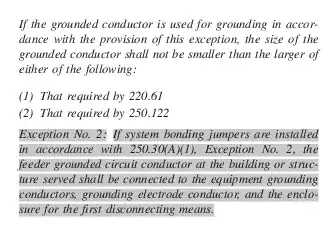

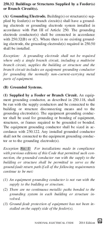

I've found several threads that address this (Can I install a Subpanel..., How can I safely connect a subpanel..., How to properly ground a subpanel...), and the consensus seems to be that NEC 250.32B Exception 1 & 2 would apply and I should bond the ground & neutral at the subpanel in the new panel and install ground rods at the detached garage.
NEC 250.32 enter image description here
HOWEVER - I have also added gas service to the garage. Does this mean that I don't meet requirement 2 of Exception 1? The gas line is bonded to the equipment ground in the house and garage as required by NEC 250.104B and NFGC 7.13.1, The gas service to the garage was installed by a contractor using a plastic pipe, but I believe a conductor is buried with it to provide electrical continuity between the garage service and the main line.
So, if I don't meet requirement 2 of Exception 1, does that mean that I need to install a ground conductor from the subpanel back to the main panel. This would be a substantial PITA.

Ok, just got off the phone with a guy from our regional building department. The conductor that is buried with the gas line is NOT meant to electrically connect the metal pipe in the garage with the main service line (& therefore house, which has metal pipe from meter). The conductor is a tracer and is only there to assist in locating the gas line. It should not be connected to the pipe at either end.
So with a plastic pipe on the gas, there is no alternate conductive path back to the house, so I'm good on Requirement 2. I just bond the neutral & ground at the sub-panel and put in two grounding rods (which should have been there for the old system as well).
