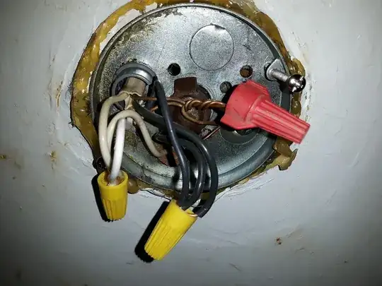

I am replacing a light fixture in my bathroom with a LED fixture. My house is from the late 20s so there are some quirks. In this case I have 3 sets of wires into the box. There are 6 other lights, basically every light in the front of my house daisy chained from this fixture.
As far as I have been able to figure, one set of wires is from the breaker, one from the switch and one to downstream fixtures. Everything works fine until I add the new LED fixture. As soon as I add that and turn the power on the light comes on then when I toggle the switch the breaker trips. Is there an issue with the fixture being LED? The previous fixture worked, I just didn't like a chandelier in the bathroom.
Any help is appreciated as I am very frustrated right now. What should have been an easy task is now a PITA.
I am adding a picture so you can see what it looks like. With it wired like this and the switch off, all the downstream fixtures work but if I toggle the switch it blows the breaker.

  • how did you try to wire the new fixture in? – ratchet freak Sep 01 '16 at 07:55
    Which country are you in? Wiring colours and arrangements vary from place to place. – RedGrittyBrick Sep 01 '16 at 09:24
  • Did you note how the wires were all connected and then connect them back in the same way, or did you just connect all of the same color wires together? – brhans Sep 01 '16 at 12:48
  • I am in Canada @RedGrittyBrick – Jhadur Sep 02 '16 at 15:10
  • @brhans - I stupidly did not note how they had them wired in previously as I didn't expect anything other than all the neutrals connected together and all the hots connected together. When I try to install the fixture I have all the same colors grouped together. – Jhadur Sep 02 '16 at 15:12
  • @ratchetfreak - Not sure I understand your question. I grouped all the neutrals (white wires) together and all the hots (black wires) together. – Jhadur Sep 02 '16 at 15:14
  • @Jhadur: As I explained in my answer (esp under Other Countries), one of those apparent neutrals is not a real neutral but a switched live. Identify it and reconnect it to only the hot wire that leads to the light fixture. – RedGrittyBrick Sep 02 '16 at 15:20

Problem
You have connected the wires incorrectly. You have probably connected the switch between neutral and live.
Wiring a light fixture
In the UK, a pre-2004 ceiling box with three sets of wires would be connected like this:
A comes from the breaker, B goes to the next light fitting. The wires to the lamp holder use the post-1977 colours.
Note that C is labelled "twin red & earth" this means it has a second red wire instead of the black wire. In practise, most electricians use normal "twn * earth" for the cable to the switch. This means the black wire is switched-live not neutral. It should be marked with red-tape to indicate this.
If you then just connect all the black wires together, you would connect the switch across live and neutral, creating the problem you describe.
The correct wiring looks like this in a typical UK ceiling rose (with post-2006 fixed-wiring colours. Arrangement is inverted compared with above diagram):
Photo - own work, © RedGrittyBrick. Licence: Creative-Commons Attribution-ShareAlike 3.0
Note the red tape on the blue wire from the switch, indicating this is switched-live not a normal neutral. See that this particular wire is NOT connected to the other same-coloured wires (blue in this example).

  • So how do you tell, other than the red tape, that the switched-live is not a normal neutral? I have a feeling that this is my issue but there is nothing on any of the wires to indicate a switched live. – Jhadur Sep 02 '16 at 15:29
  • @Jhadur: You turn off the breaker, separate the neutral wires, make them safe, turn on the breaker and, using appropriate [tools](http://diy.stackexchange.com/q/90038/2815) and [procedures](http://diy.stackexchange.com/q/47613/2815), test each of the neutrals to see which becomes hot (referenced to, say, a known good ground) when you operate the light switch. – RedGrittyBrick Sep 02 '16 at 15:34
  • Awesome! Thanks! And just to confirm, that switched live gets grouped with the hots. I assume the other wire from that pair gets left with the hots, going from your diagram above. – Jhadur Sep 02 '16 at 17:07
  • The taped white is supposed to be an always-hot, to make it easier to identify. – Harper - Reinstate Monica Sep 03 '16 at 04:30
  • I agree. One set of black white runs to the switch. Usually it's labeled with a tag of E tape. That's why the breaker is popping. – Trout Sep 03 '16 at 13:08
  • @redgrittybrick I found the switched hot and the light turns on and doesn't trip the breaker but now the switch doesn't work. The light stays on if I toggle the switch. Is it possible that the switch is damaged or is something still not right with the wiring? – Jhadur Sep 05 '16 at 22:51
