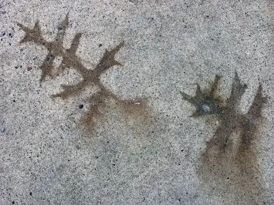

My driveway was poured when I was on vacation and leaves fell on it and they made a black mark I believe it's called tar leaf in about 20 places in the driveway and before they come and seal it I wanted to know how to get it off before the winter comes and the Salt destroys it

Tannin , get used to it. Unless you are going to paint it , the concrete will weather. Tannin stains will come and go. I use a 50:50 bleach/ water and a garden sprayer every coupe years to make my wife happy.

Tar leaf, simply known as tar, is caused from the organic pigments that give leaves and pine cones their color get embedded in the micro-pores and small voids on the surface of the concrete. They can be hard to remove without a good detergent and some scrubbing action. The best detergent to use is one with bleaching action or ammonia. Typically detergents designed to remove organic stains (blood, food stains, etc.) work best. OxiClean is one example. Granular detergents offer an added benefit, because they provide additional friction when you scrub the surface.
Here are the basic steps to follow:
Use a pressure washer to remove all solid leaf matter and debris from the concrete.
Apply a household detergent (as recommended above) to damp concrete. Let it sit and wet out for a few minutes.
Scrub vigorously with a stiff broom or scrub brush.
Rinse the concrete with water until you remove all the soap.
If this procedure doesn't completely remove the stains, repeat the process.

  • I don't think I would chose to use a pressure washer on fresh concrete. A weak Muriatic acid and water solution would etch the stain off. but the detergent may be the best method but requires more physical labor. – Ed Beal Sep 13 '16 at 13:16
  • I have different nozzles for the pressure washer and the weaker one has been fine.buy I do understand your point thank you..I have the dry detergent and bleach liquid and crystals and I will try all if I have to before they come and seal it..thx again – Steven Schultz Sep 13 '16 at 22:04
