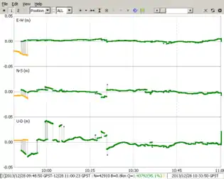

Differential code+phase static positioning relative to an IGS station. Short base vector length.
Base station: EUREF/SVTL
Date: 2013-12-28 (WEEK=1772 DOY=362)
Time interval: 100 ms
Time alignment: 1s
Distance to base station: ~0.8 km
Geoid model: EGM2008
Measurement site: near SVTL
Antenna: Trimble Bullet III 3.3V
Receiver: EVK-6T-0

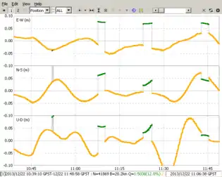

Differential code+phase static positioning relative to an IGS station. Medium base vector length.
Date: 2013-12-22 (WEEK=1772 DOY=356)
Time alignment: 1s
Distance to base station: ~20.2 km
Measurement site: Suulajärvi
Receiver: EVK-6T-0
