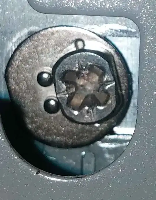

This is a screw on the side of an IKEA drawer. On line videos say turn it left or right to level the front of the door. Instructions are to use a Phillips screwdriver. It's not a Phillips head and the local hardware store doesn't recognize it. enter image description here

That's a Pozidriv head that might have been chewed up a little by the inappropriate use of a Phillips screwdriver.

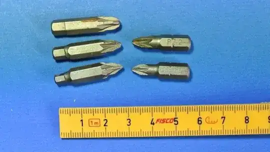

Pozidriv screwdrivers come in three main sizes, usually named PZ3, PZ2 and PZ1 from largest to smallest. There is also a rarely seen PZ0. The most common is PZ2. You should use the largest bit that will engage the screw fully.
Here are some examples of Pozidriv screwdriver bits for interchangeable-bit screwdrivers (hand screwdrivers and power screwdrivers)

    From the looks (i.e. quite blunt) of the bottom of the hole in the screw head, it might be worth trying a #3 bit first. – Andrew Morton Jan 16 '17 at 18:42

Definitely a pozi-drive screw. A pozi-drive bit fits tight but a regular phillips will cause the damage in the first pic.

This looks like a Pozidrive screw. The little shallow star shape is easy to spot.

Ikea is Swedish so it's definitely not philips! Pozidriv two normally works unless really chewed up. This screw rotates an eccentric cam so is a bit stiff. Place a wide rubber band under the screwdriver tip and a lot of feed (pressure) holding the drawer firmly. Sometimes gives you a bit more grip.
