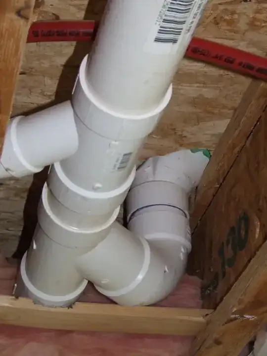

I feel like I should cut the PVC below the subfloor, and reinstall a new offset valve higher than the old one. But space is cramped beneath the floor, and I'm afraid I'll make things worse.
Toilet piping below floor
Toilet piping below floor close-up
I saw some videos online about separating PVC with extreme heat, but I'm afraid of igniting my house or sewer gases (I have a septic tank) or both. I have minimal PVC experience.

Plumbing trick...You are basically going to make a coupling out of 4" PVC pipe. Cut 3" pipe below the floor even with the top of the hub on the 3" elbow. 4" PVC pipe will fit perfectly over the 3" hub at the top of the elbow. Glue 3" hub to the inside of the 4" pipe. Next, your "new" offset flange hub will glue into the 4" pipe.
