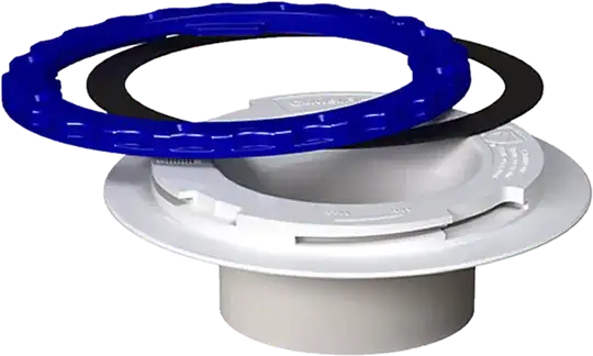

Adapters
There are adapters available, that solve this exact problem. The [Set-Rite Toilet Flange Extender Kit]; described in the answers to this question, Comes with different size spacers, which allows it to compensate for various sized offsets.
Edit: Original link broken, so screencap photo inserted instead: enter image description here
