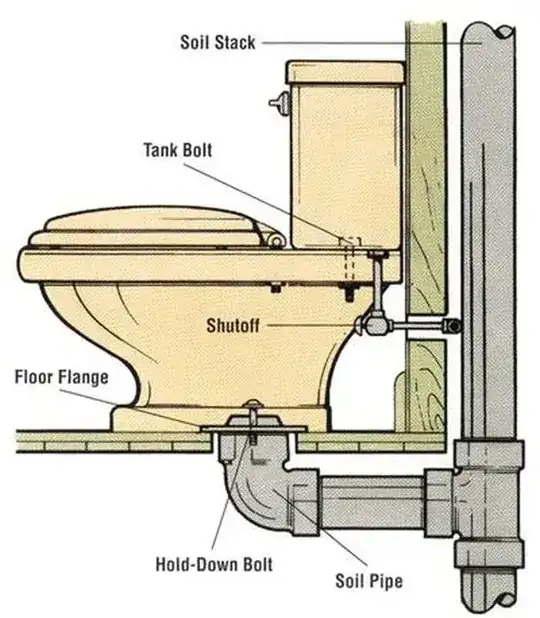

What are the best practices or other rules such as building code regarding how to set the height of a toilet flange relative to the finished floor height?
Example of the type of flange I am referring to: enter image description here
I have read conflicting information - some statements that the top of the flange should be flush with the finished floor, others that the bottom of the flange should rest on the finished surface.
