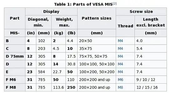

A more detailed table, including screw specifications, from Wikipedia:
VESA table
Notes:
  • If a screen is heavier or larger than specified in table 1, it should use a larger variant from the table, for instance a 30-in LCD TV weighing more than 50 lb (23 kg) would need to use a part F mount.
  • The weight limits were unusually chosen as round numbers in kg or lb for different sizes.
  • The screw lengths for part C, D and E become whole numbers when adding a 2.6 mm thick bracket (which is how the standard describes them).
  • The screw lengths for part F are minimum / maximum / hole maximum, as in: M6 screws must go at least 9mm in but at most 10mm in, and the hole might not be deeper than 12mm.
    The minimum length is important for strength. The maximum length is also important. You don't want the screw to force its way into the inside or to bottom out in the threaded insert so that it can't be properly tightened. Some mounts come with screws that are longer than necessary and then use spacers behind the mount to correct the effective length. If you use one of those screws as a guide at the hardware store, make sure you have any needed spacers.
