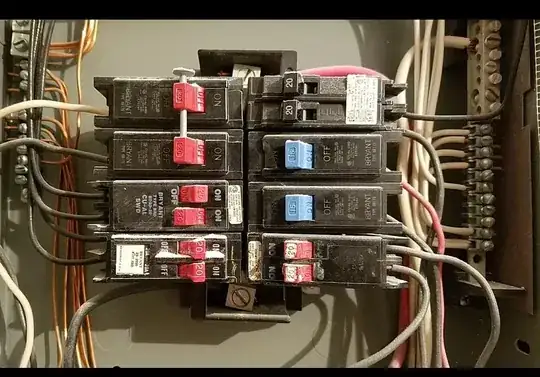

This is my breaker box; I'm concerned about not having enough space to accommodate an electric range which requires 240v 40A. My box has tandem circuits, although I'm not sure if consolidating additional breakers will free up 2 slots, which is what I need.
Is it possible to extend the poles to create more slots? Panel door has cut-outs for additional breakers, but the concern is overloading the system.

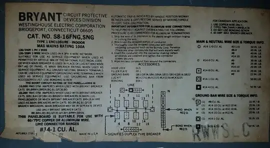

  • Yes, it's an apartment, but I have my own meter in the basement. I don't know where the main breaker is, but it's probably in the basement too. I think the panel is 100A max (look at pic #3, under word "INDOOR") – raffian Jun 24 '17 at 04:20

First, you say your service is 100A, but those "main supply" wires look awfully small for 100A. They look a lot like #6 copper, which is only good for 60A tops. I would make sure the wires are appropriate for the main breaker. If they are inadequate, either upsize the wires or downsize the main breaker.
This ... I hesitate to use the word "service panel" ... is still supported. Bryant was bought by Cutler Hammer, in turn bought by Eaton, and became Eaton's "BR" service panel line. "BR", Bryant, get it?
Yes, you can get a "quadplex" double-stuff which fits in two spaces and supplies two 240V circuits. This quadplex will have proper and internal handle-ties, NOT A FLIPPIN' NAIL. For instance this quadplex includes a 2-pole 40A and a 2-pole 20A. It would replace the breakers with the nail.
enter image description here source
That breaker isn't just two twin breakers bolted together. It is purpose-built to be a quad. Internally there is a mechanism to assure both sides of the circuit trip together if either overloads (common trip). That works with or without the goofy looking handle-ties. The handle-ties are just UL listed versions of a nail; they are there to provide common maintenance shut-off. With a nail (or listed handle-tie), common trip is not guaranteed.
You cannot add any more breaker spaces to this panel. The cover has additional knockouts, but there'd be nothing under the knockouts. This is an 8-space/16 circuit panel, you are using 14 and have only 2 more possible.
After this you can add 2 more 1-pole circuits or 1 more 2-pole circuit and your panel is wedged solid. You might want to think about a bigger panel at some point. Get a panel so large that you never, ever need to use double-stuff breakers. (because increasingly, they are requiring GFCI and AFCI breakers, and those don't come in double-stuff.) You need 14 now, 24 is borderline too small, I would go at least 30, even 42.
You don't need to deprecate that panel, you could add a larger panel as a subpanel fed by a large breaker.
You could stay in "BR" panels if you really wanted to, it is still common and supported, though a bit on the cheap side. Siemens is commercial grade (so are CH and QO, but their breakers are rather expensive).

  • I think I understand; the two breakers (with the flippin' nail) use 2 pols for 20A/240v. You're saying replace those two slots with a single quadplex; the 20A half of the quadplex powers whatever was connected to the breakers before, and the remaining half of the quadplex is 40A 240v, exactly what I need for the range; Is that accurate? – raffian Jun 24 '17 at 04:25
  • @raffian Yes, and both halves (inner two and outer two) both are 240V. *But it's more than that*: they do not rely on that weird piece of metal for common trip, they have an *internal* mechanism for that. The weird piece of metal is used for maintenance shut-off only. That's the trouble with a nail (or even a listed handle-tie): does not guarantee common trip. – Harper - Reinstate Monica Jun 24 '17 at 05:11
  • I inherited the nail when I purchased the unit; I would never put metal near a breaker box, much less a nail connecting two breakers; seriously, whoever did that has guts or a death wish! :-D – raffian Jun 24 '17 at 14:13

I agree with @Harper completely, but I keep looking at you pictures and I am trying to figure out what this structure was before it was a dwelling. I am looking at my 1965 NEC and even that required a minimum 100A service, 2 - 20A small appliance circuits, a washer, a dryer, and a range receptacle, along with general purpose receptacles and lighting circuits. Throw in AC and heating and a water heater and you don't have enough circuit space. Also the feeder @Harper pointed out, the minimum size would be a derated 100A feed of a #4 conductor. So there should be a Main Breaker or Fused Disconnect somewhere. Can you tell us what size it is?
Also I try not to advise anyone from using small tandem breakers on anything except 15A and 20A circuits. If you look at these breakers you will see you have the same contact size for the buss for a 70A two pole breaker as a 15A two pole. So large heavily used amperages have a tendencies to burn out the panel buss and breaker at their point of contact over time.
My advice is to forget trying to add circuits to this panel and do an upgrade and at least bring it up to NEC code standards.
