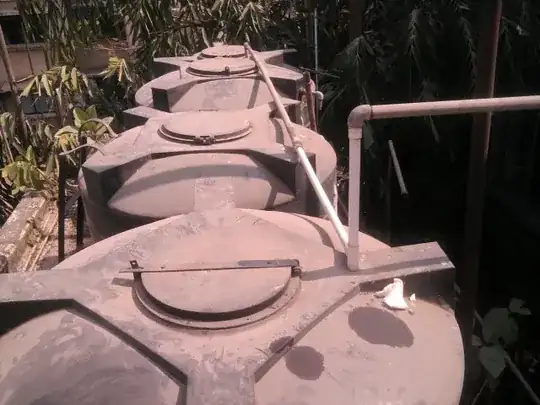

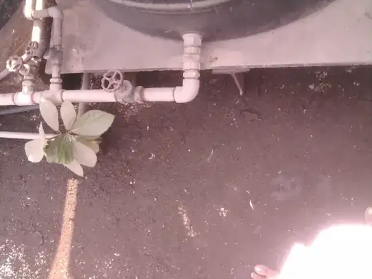

I have a leaking water tank here in Bombay, India. I'm looking for suggestions on how to repair it.The tank is a plastic Sintex water tank. There are cracks around a water pipe running into the side of the tank. I am looking for approaches to sealing the leak. I believe soldering/welding is one option, but I think using some kind of sealant on it might also be an option. Opinions on the pros and cons of each approach would be helpful. Specific recommendations for sealant would also be helpful; I'm not sure what to look for. Here are some photos of the leak. In order, they show:
  • A row of tanks.
  • The pipe leading to the leak.
  • A closeup of the pipe leading to the tank.
  • A closeup of the cracks in the tank areound the pipe.
  • Another closeup of the cracks.
A row of tanks. The pipe leading to the leak. A closeup of the pipe leading to the tank. A closeup of the cracks in the tank areound the pipe. Another closeup of the cracks.

    At least for the bottom photo, the crack appears to be caused by movement of the pipe. So however you seal the leak, be sure to install some kind of framework to stabilize the pipes themselves. – Bob Sep 27 '12 at 15:16

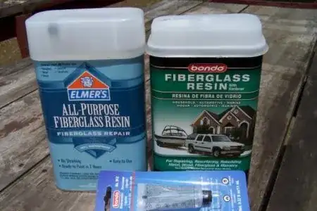

You can use a few methods.
I would recommend using fibre glass firstly and then maybe some sort of epoxy /putty.
FIRST AND MOST IMPORTANT
You will need to clean the areas that you are going to work with. And i do not mean like wipe with a tissue.
  • I mean take some sand paper and lightly scratch the surfaces so it scores it to give better grip to the adhesive.
  • You can do the same around the steel pipes you want to bond, but you will have to be more vigorous in making scratches in the metal.. this will help very much in bonding! It will not stick to flat surface very well.
  • Try to work with gloves and avoid touching the area you are working with. Your fingers leave oily substance and can cause the bond to be weak.
  • Using a clean cloth, spirits /alcohol (cannot be oily) clean the and blow out any dust residue, any particles from sanding, and wipe it clean with alcohol /spirits before you start to apply any methods.
  • Make sure that during the cleaning and curing (drying period of at least 48hours) there is no water leaking in the affected area.

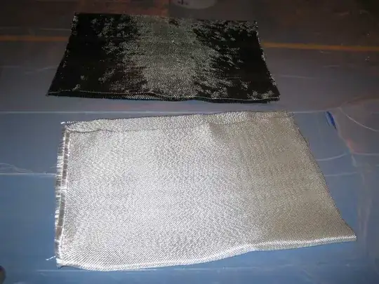

Fibreglass
You can buy fibre glass sheets pretty cheap, they are used in the boating industry, car body shops and some building supplies.
You will now clean the are and apply the fibre glass sheets in single layers, fold and mould them to the shape you desire. During this process you will apply resin (it is very sticky so use gloves again) and dont be shy.. use plenty of it per layer.. let it dry a bit, come back and add another layer and expand over the bottom one. Maximise surface area.
Here is an example on PVC pipe, patching up a leak. ON a steel pipe you need to wind it wider out to maximise the bonding surface, especially if its under pressure.
