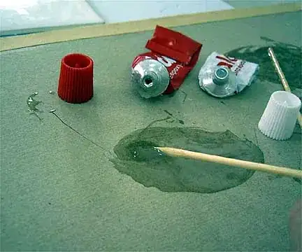

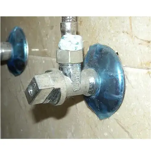

I am not entirely sure what you would like to do but you can attach almost anything with steal putty or epoxy resin.
Steal putty
Epoxy Glue
Both of which require to mix two parts into a single part (usually in equal parts) and they are non-toxic (but check the package before use)
You can either mould over or around the pipe glueing it to the surface or sealing it water tight.
Some examples

  • In your third picture, it looks like you put the putty on the outside of a water line. A water line in my area is around 45 psi. How did that solution hold up after some time? At low or no pressure (like OP), I assume these would work nicely. Do you have any other examples of these methods under pressure? – Zach Mierzejewski Nov 13 '15 at 19:09
