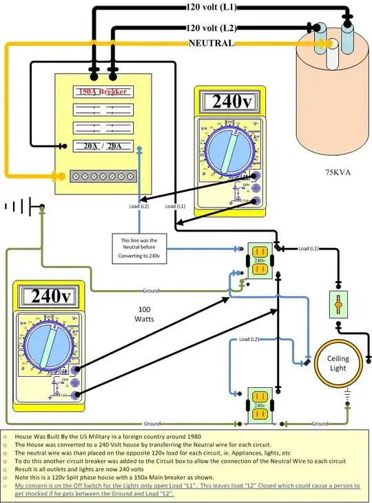

House with split phase 120v converted to 240v I would like to use the ground wire as neutral to convert one outlet on a 240v plug to 120v. see attached on use of ground and let me know. [![enter image description here][2]][2]

    It is amazing the crazy stupid things that people come up with. This is one of the worst that I have seen. – Michael Karas Aug 28 '17 at 12:57
    Dear Michael, thank you for your comment, keep in mind the forum is used to as questions and review and as built conditions. At present the house is ok and I was just asking about the use of a ground. Your comments should be offered in an air of assistance instead of as an intelligence rating. There is a lot of information on use of ground and neutral circuits. Any ways you thoughts appreciated, – mofsubic Aug 28 '17 at 13:11
    Google Image Search doesn't see this graph anywhere else on the web, so maybe you made it yourself. Blue is an odd choice for either neutral or L2. If your installation actually uses black, blue and green, *you are in conduit*. Get some red wire and fishing tape, and pull the extra wires you need! – Harper - Reinstate Monica Aug 28 '17 at 19:57
  • Can you explain what you *actually want to power* here? – ThreePhaseEel Aug 28 '17 at 22:24
  • A can opener and hard boil egg cooker. It's only 0.5 amps – mofsubic Sep 01 '17 at 23:41
  • Yes I made the figure schematic to show the actual condition, keep in mind were in an area without inspection or licensed electricians. I was wanting to check this ground condition – mofsubic Sep 01 '17 at 23:45
  • Please post a new question with your new schematic -- that way it can get the attention it deserves – ThreePhaseEel Sep 02 '17 at 21:34
  • It would help a lot if we could see how the cables are grouped. We also need to see exactly how the hot(s) and neutral are punched into the panel. Are each of the circuit breakers now 2-pole (double) breakers? Is the panel's neutral bar used for anything at this point? – Harper - Reinstate Monica Sep 02 '17 at 22:16
Do NOT do this. It is wrong in so many ways:
  1. Completely illegal from the electrical code standpoint.
  2. Using a 120V outlet for 220V application is incorrect and confusing.
  3. Mixing 120V and 240V on the same outlet will lead to dangerous mistakes.
  4. Redeploying a safety GND line as a Neutral is going to get someone or some equipment fried.
Put the house back to the proper wiring at 120V on outlets that are supposed to be 120V. Then if 240V is needed to some specific outlet location run the proper type of type of wiring cable with L1, L2, N and GND from the 240V breaker to an outlet specifically designed and rated for 240V operation.

  • In the electrical trade, the conductor of a 2-wire circuit connected to the supply neutral point and earth ground is referred to as the "neutral". [1] – mofsubic Aug 28 '17 at 13:36
    In the medical trade, a neutral connected to earth ground *at any point other than at the main service panel* is referred to as the "cause of death". – A. I. Breveleri Aug 28 '17 at 17:02
  • Well said, but I was hoping to understand why? Appreciate and respect your response. – mofsubic Aug 28 '17 at 23:28
  • @mofsubic the neutral and ground can only be bonded together at the service panel. Otherwise you get neutral current on the bare ground that could be deadly for someone since they expect that wire to be safe. Also, in the case of a ground fault, you will get ground fault current flowing on the neutral wire. The National Electrical Code prohibits this for safety reasons. – ArchonOSX Sep 02 '17 at 22:50
Your design lacks some basic understanding of how mains electrical is done. These are often seen in EE's who cross over from low voltage DC to mains... or who try to learn by asking questions (it's soon revealed they have too little knowledge to know which questions to ask.)
Neutral is not ground
Unfortunately in the low-voltage DC EE world, they use the iconography of "GND"/ground/earth to refer to the normal current return, which often doubles as an RF shield. In mains electrical, we do not.
The standard for mains wiring is to wire it in the manner of an isolated system. All live conductors are entirely isolated from the equipment safety ground, which is fixed to actual earth. Then, to prevent the live conductors from rattling or floating to an excessive voltage, they are biased relative to ground by one single location. That location is the main service shutoff. The bias is 0V; it could be 3V but bonding straps are cheaper than transformers.
Hot(s) and neutral are simply the various taps of the output transformer, all of them live current, and you hope neutral is within 5 volts of ground. If neutral were 120V away from ground, everything should still work. **
And the ground wire should never, ever, ever flow current unless someone is pushing "test" on a GFCI tester.
So bootlegging the ground wire to be neutral is out of the question. Perish the thought. Not gonna happen.
Also, don't think like it's OK to tie neutral and ground together where convenient. The N-G bond is at one single location for very good reason.
The correct cable
In multiconductor building cable, the ground wire does not have insulation. It can't to avoid touching things which should be grounded, like the metal box. Remember, neutral is not ground, and there may be a voltage differential between neutral and ground. That could cause arcing in a metal box which is grounded otherwise.
When you need a third live conductor, they make multiconductor cable called /3 which contains black, white, red, ground, giving a second hot. If your installation is in conduit, simply add (pull) a white wire to be a proper neutral. The ability to do that easily is why your builder spent the extra money on conduit.
In a 240V-only circuit which does not need neutral, there is nothing wrong with taping a white wire and using it as a phase or pole. However you cannot do the reverse, and you cannot mark wires to be grounds or mark ground wires to be anything else. (unless they are larger than 6AWG).
You can, however, retrofit ground if none is present.
The correct sockets
Obviously... you must not light up a NEMA 5 socket at 240V -- or a NEMA 6 socket at 120V.
If you really want a 120+240V NEMA 5+6 combo receptacle, they do make those. I believe it's even legal to wire them to a single split-phase 120/240V circuit. I consider it sloppy practice though, and would simply run another set of /2 cable or another pair of wires to accommodate the 120V, either on a new or existing breaker.
Breakers do not work as you have illustrated
I don't know if you know this, but you must not feed a 240V or 120/240V circuit from two separate breakers. For one thing, side-by-side like that, they'll be on the same pole (unless they're Pushmatic). A 240V circuit must have both common trip and common maintenance shut-off, and in some cases GFCI. That is only possible in a 2-pole breaker. In a panel of the style you drew, those will be on left or right side occupying two spaces.
Currents must be equal in each cable or conduit
You sort of drew the circuits as open loops. Actually in each cable or conduit, currents must be equal - if 6 amps flows in one direction on some wires, 6 amps must flow the other direction on others. That means while we may conceive some wiring as loops, it is actually wired as a tree topology and loops are bad news.
** In fact, I have had that exact condition, where a certain screw in my neutral bus failed to bond it to ground, and I inadvertently installed a true isolated system. A ground fault later pulled ground up to L1 (or to be more precise, L1 down to ground) pushing neutral 120V from ground. The point is, everything still worked, just bonded where not expected.
