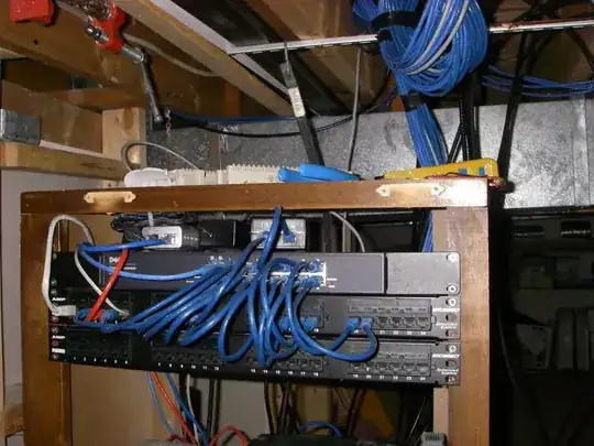

Here's how I have my house terminated, including patch panel. Note I have a 16-port switch, then the patch panel. There's only one analog telco line (port 4), the rest of my phones are VoIP (there are two power injectors on top of the switch for a couple of those phones).

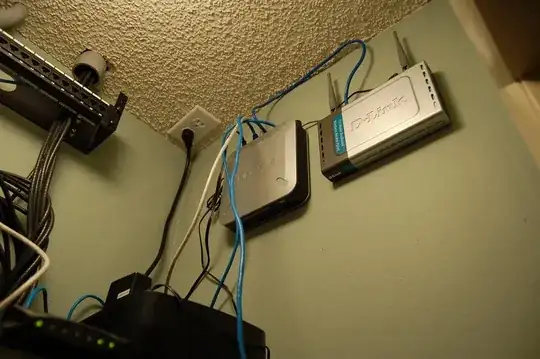

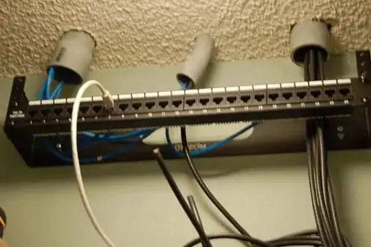

In a prior house, I added network cables and a patch panel to a closet. This picture was taken way before I finished the job, but you will get the general idea of it. I dropped all of the cat5e out of the left conduit, the coax out of the right conduit, and the middle conduit was the "service" lines (ie cable from the phone company, cable company, and eventually my antenna). The conduit didn't really go anywhere other than up into the attic, it just provided a neat way to transition from the attic to the closet while being able to get above my insulation and not having it falling down into the closet. I eventually used some spray foam in the conduit to seal off the heat that I had leaking into the room from the attic.
I then mounted my router and wireless access point to the wall.
There was already a shelf that is just off the bottom of the image that I placed things like my battery backup on.

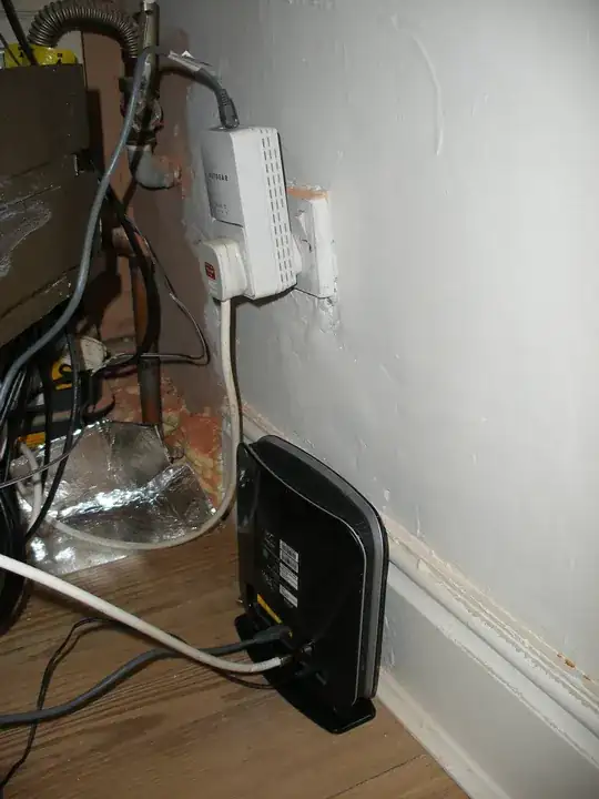

The router sits downstairs, and it's first ethernet port goes straight into a cheaper model Netgear Powerline.
Then in every room I require an ethernet connection, I have purchased a Netgear Powerline switch, which requires only one cable! It's own power source also acts as its network source, so by simply plugging the little device into the power, it automatically works as a network switch.
That's about it really. I now have a fully wired network house for less than £100, and I can't fault it at all.

Have you considered powerline networking, for example BT Homeplugs? This uses the electrical circuit in the house as the network cabling.
I recently ditched the WiFi in my three-story house. I now have the broadband router right beside where the phone line main socket is, flooding the downstairs in lovely WiFi. I then have a LAN cable from that into a BT Homeplug, and more homeplugs upstairs where I need them. Works like a charm at high speed and saves you having to dig trenches in walls and run cables.
Unless the electrical wiring is ancient you should be fine.

    This is for a new house so the electrical wiring would have no issues. I don't think you really answered his question though. – Kellenjb Mar 20 '12 at 14:23
    Kellen is right, those powerline network devices exist because they solve a problem: _how can I get a wired network without pulling new wires._ But in my case, I _can_ plan those wires ahead of time, and that's bound to be more efficient. Also: wall warts, eww. – Torben Gundtofte-Bruun Mar 20 '12 at 14:29
