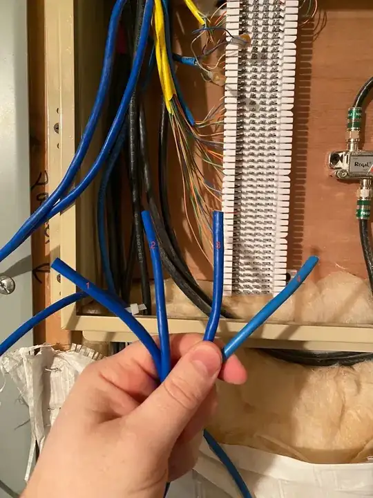

My current setup is I have a single router/modem combo in my living room connected through DSL. Internet is distributed through the house via WiFi.

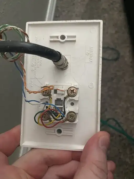

The upstairs rooms have all been run with Cat5e cable from the cable box and terminated with 6pin connectors. Important to note that even though all the rooms have been run with Cat5e cables, I can only plug the modem/router into one of them to get internet. So something is already wrong.
upstairs connectorback of upstairs connector

I am also hoping to be able to identify and name some of the things in the cable box to help me better understand what is happening.
Questions:
  1. In the first picture, what is the white board(labelled A) called?
  2. How do I trace cables?
  3. Why do I have 7 cables going into the board if I only have 3 outlets upstairs?
  4. Is there a reason other than material availability for why some of the cables are yellow and some are blue?
  5. Can I just swap out the upstairs 6pin connectors with 8pin RJ45 connectors?
  6. How do I hook everything up and distribute internet throughout the house?
cable box unterminated cables 1,2, and 3 are the cables run from the basement. 4 was existing and just tucked behind the cable box.

  5. 6-pin RJ11 outlets are no good for Ethernet - those are telephone or DSL connections only! Fortunately, it looks like they used Cat-5 cable, and the extra wire pairs seem to be coiled up behind the outlet in your picture, so you can probably install a 8-pin RJ45 outlet instead without any issues. The outlet should be labeled to show you which wire colors go where.
That's called a 66 block. They're used to patch phone lines together.

Tone generator. You can find these online. You get a generator you hook to one end, and then a "wand" for the other. When hooked up, it makes a EMF "warble" that the wand can find just by being close to the wire. A decent one should give you clips, RJ45 (Ethernet) and RJ11 (phone). If I were you, I would want one that does wire testing as well. You're going to need to know if you missed a pin somewhere.
While each Ethernet cable can supply up to 4 phone lines, most likely you only needed one per run. The other runs may go to boxes that had blanks installed over them
Yes. It's the basement that will need more work.

You can use the 66 block, but it's not advisable. Your Ethernet is filled with twisted pairs. If you look at, say, Cat 3, you'll note they aren't twisted at all. Why? Phone lines aren't concerned with something Ethernet is: shielding. Untwisting the wires and peeling back the insulation has reduced the shielding of those wires. Ethernet is more susceptible to interference than phone. The 66 block could work, but your mileage may vary.
The other hack to avoid here is crimping a RJ45 jack on (it's far too easy to mess them up and shorten your cables too much).
While a punch board is the easiest route, you might not need all 7 wires used for Ethernet. If not, you could just end the wires you want with a simple Ethernet keystone. These are much easier to find (punch boards at your local hardware store are almost always overpriced anyways) and they keep the shielding intact. Then you attach a patch cable between your router/switch and the wire keystone. Note that you can use Cat6 on Cat5e wire (they're just slightly more expensive due to more shielding)
