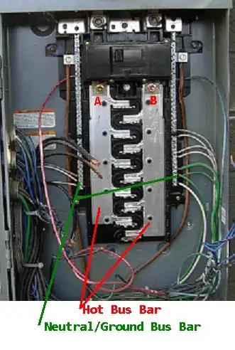

If you look at a service panel without any breakers in it, it will look something like this.
Notice the thick metal plates running vertically, those are your hot bus bars. One is L1 (A), and one is L2 (B). They are each at 120V potential to ground/neutral, and 240V potential to each other (So don't frigin' touch them!).
When you add breakers, they will make contact with the hot bus bars using the tabs that protrude between the bars.

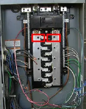

You'll notice on the cover of the panel that each slot is numbered, with odd on one side and even on the other. So for a 20 breaker panel you'll have.
1    A    2
3    B    4
5    A    6
7    B    8
9    A    10
11   B    12
13   A    14
15   B    16
17   A    18
19   B    20
So 1 & 2 will be on leg A, 3 & 4 on leg B, and so on down the panel.
What types of things are fed by each breaker will determine which leg is used more. For example. If breaker 1 feeds the lights in your living room, and breaker 3 feeds your bedroom lights. If you turn on the living room lights and turn off the bedroom lights, leg A will be used more than leg B.
For 240V circuits, you'll use a double pole breaker that spans two slots on the same side (eg. 2 & 4). This means it will have a hot from each leg, and will use each leg equally.
So the short answer is... It depends.
