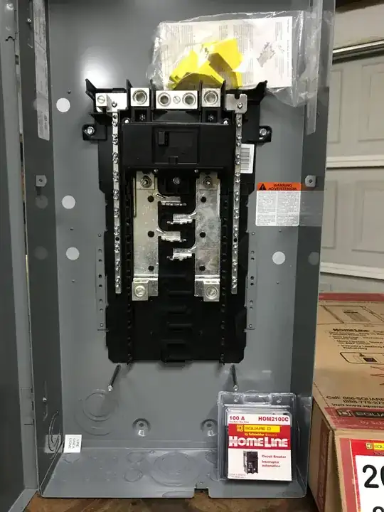

OK, So I’ve update my wiring plan … see images. I have more details now, such a part numbers, specifications and ratings, etc. I’ve consolidated much input from a couple of forums as well as Stack, and tried to achieve a synthesis of everything that sounds right, from people who have good ratings and seem to know what they’re talking about.
So, out of the meter we come into a 200A main breaker load center, Square D part number HOM816M200PFTRB. The neutral is bonded to ground bar ONLY EVER at this panel. From the panels ground bar we ground to the PoCo’s ground wire running down the pole, which is a #6 or #4 AWG bare copper wire using a Burndy split bolt part number KS22BAG1R.

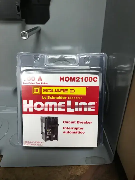

Although the panel had feed thru lugs, I decided to go ahead and get a 100A breaker for the house run, because the actual cables themselves are only rated for 100A @60deg C (assume worst case) and it didn’t seem right to hook them to a 200A bus. However the feed thru lugs are there if I need them. We also have a GFCI breaker with 12/2+G UF running about 25 ft to a standard receptacle in a weatherproof enclosure. This seemed more of a correct “hierarchical” solution that people seemed to suggest was better.

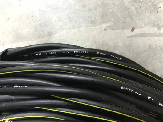

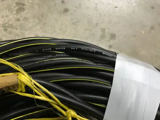

For the lateral run to the house the PoCo has supplied me with 1/0-1/0-2 direct burial Aluminum cable. I also wanted a ground to the house, so I ordered a stretch of Mercer 4 AWG Single Aluminum Conductor 600V URD to serve as the ground wire back to the main panel. I was informed by my trenching contractor that gophers are a huge problem and that I had darned well better use conduit. The PoCo confirms this. So all 4 of these conductors are going into 2” Sch80 PVC, and using sweeps at both ends to smoothly bring the cable up. This all goes in a trench 24 inches deep. I do not plan to glue the PVC.
At the house (very small really, 16x24 feet) we have a 100A main breaker panel, square D part number HOM2040M100PC1AVP, neutral NOT bonded to ground. From here we connect to 2 ground rods buried horizontally 24 inches deep in trenches 6 feet apart. The rocks are terrible and it is almost impossible to get below 24” if that. The local electrician said that is what all the electricians do out there. I’ll try to get them to 30” but I can only do the best I can.
Finally out of the house panel we will run, from a GFCI 20A breaker, 10/2+G UF to the shed which will have a light and a 20A receptacle.
IN THE FUTURE (months): I will be wanting to hook up a Reliance 3006HDK generator transfer switch to a genset with a bonded neutral to the house panel

Final Changes
  • Swap out the pole panel’s 200A main breaker for a 100A main breaker, Square D part number QOM2100VH. And move the house cables to the feed-thru lugs.
  • The ground cable is going inside the conduit, I misdrew that, sorry
  • Install a ground rod at the pole .. leave the PoCo’s alone (even though the rep said it was okay)
  • Find some way to get those dang rods 36” deep, or hire a doggone drilling rig to get a 8 foot bore hole. and also maybe lay a stretch of bare wire in that trench. I’m not kidding, guys … it’s that bad. I don’t think I can do the concrete ufer thing, concrete out there is gonna be tough, and I really don't have an application for the concrete, at least not yet.
  • LOSE THE HOKEY POKEY TRANSFER SWITCH. Thank goodness, I see the light. I’m going to go with the interlock option. Square D part number HOMCRBGK1C, which I have confirmed is correct for my load center which is HOM2040M100PCVP. This should provide a code-compliant physical barrier to goofing it up.
  • I have a confession. I jumped the gun a couple weeks ago and have already installed the panel in the house, that’s why it ain’t coming out. I throw myself on the mercy of the forum :-O And I swear there will never be enough load at that place to go over 20 spaces. Seriously. No way. It’s just a weekend getaway.
  • I’m going to go ahead and glue the PVC but I’m going to skinny the pipe onto the cables before I glue it up.

Busbar ampacity does not matter, but your setup doesn't fix what was wrong with the original outside panel
The idea behind the outside panel I recommended was that you fit it with a 100A main breaker (QOM2100) and then use the subfeed lugs for the feeder conductor. Provided the correct main breaker is installed, the busbar ampacity simply needs to be sufficient to carry the current -- putting a panel with fatter busbars in is no different than having 10AWG run 75' to carry 20A to a shed due to voltage drop.
Furthermore, your insistence on a 100A panel for the house is penny-wise and utterly pound foolish -- you can't get 100A panels with more than 20-24 slots, as you probably observed, while a good 200A panel will have three times as many slots (yes, 60 slot 200A panels exist). Having to replace a panel because you didn't provision enough slots for expansion originally is an all-too-common story on this Stack, so that's why we recommend going big on this front.

You didn't mention upsizing the pole breaker to 200A. Feeder lugs there are pointless unless you also upsize the cable to 200A capacity or Aluminum 4/0. "Didn't seem right" - A 200A breaker can't even begin to protect a 1/0 cable let alone a #2. These things can't be left to Providence, that's why we have a Code.
The 1/0 - 1/0 - 2 cable will work fine. #2 is sufficient for 100A under table 310.15(B)(7), and the 1/0 is a bonus hedge against voltage drop. I've been looking for a code cite that allows reducing neutral size, haven't found it, but if it ever turns up, you can kick up to 125A. It's not a service lateral, it's a feeder, and I did find a clause at paragraph 310.15(B)(7) that says you can use the service lateral ratings for feeder that serves the purpose of a lateral.

  • Is there a reason you don't simply have him swap the main breaker on the exterior panel to 100A? That was the original idea behind what I was proposing, and would let him use the feedthrough lugs... – ThreePhaseEel Feb 28 '18 at 12:34
  • I'm hearing also that I cannot bring those cables indoors (they will be in Sch80 pipe coming up from the floor) because of their insulation. Can someone confirm this? – Kerry Thomas Feb 28 '18 at 12:58

  • @ThreePhaseEel because I missed the detail that he had bought a feed-thru-lug panel... – Harper - Reinstate Monica Feb 28 '18 at 15:08
  • @ThreePhaseEel, I am going to get the 100A main breaker for the pole panel – Kerry Thomas Feb 28 '18 at 15:08
  • @KerryThomas oh! Then you don't need that 100A breaker in your photo, yes, use TPE's main lug method. Nice rhing about the Orange/blue Borg is an insanely good return policy, I've even returned things to Lowes that I bought at HD. – Harper - Reinstate Monica Feb 28 '18 at 15:15

  • @KerryThomas I have never heard of outdoor caboes you can't bring indoors, I doubt that is a thing. I have heard of *wires* such as THHN that are rated to be inside conduit but not rated to direct-stapled to joists the way you do with NM or UF cable. I'm not sure what category your wire falls in. If you must extend conduit to the panel, put "conduit bodies" at all the turns you can, you'll thank me later lol. – Harper - Reinstate Monica Feb 28 '18 at 15:31
