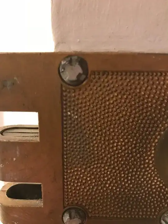

Anyone know what bit would fit this? I have only seen the 2-prong spanner bits...

Here's what I eventually did to get the screws out:
  • Used a Dremel rotary tool with a metal cutting wheel on it
  • Cut slots across the head of each screw
  • Used a flathead screwdriver to remove them
Hope that helps anyone who might come across this issue in the future.

These are indeed very rare. And old. Google image search kept showing old radio sets.
After a lengthy search I found one source that should do the trick for you.
Microtech Medium Domed Tri-Wing Wrench Tool Bit (bladehq.com)

    Wow, thank you so much! I also did a lengthy search but came up empty. I also tried unsuccessfully to tap one out with a hammer and a screwdriver but it didn't budge, so you have really saved the day! – Rawshark Apr 21 '18 at 15:27
  • Soooo it seems the size is way off. I posted another pic in the original post above which shows how tiny the bit is compared to the screw. Any other ideas? https://i.stack.imgur.com/Ns1AF.jpg At this point I'm also open to the best way to remove them without a bit (drilling, tapping etc.)...? Thanks for any help! – Rawshark Apr 29 '18 at 14:58
  • Maybe vice-grips? – SDsolar Apr 29 '18 at 15:56
  • Yeah I tried that but the screw head itself is tapered so there is no way to get purchase... – Rawshark Apr 29 '18 at 18:34
    No worries - Dremel to the rescue! Cut a slot in the head and used a flathead screwdriver. – Rawshark Apr 29 '18 at 21:23
    RIGHT ON! Would you please post that as an answer? Make it longer than a comment, and simply give a step-by-step solution. SE will make you wait a day or two then you should accept it. Remember, we are building a database here that will last for years. I often find that Google sends me to Q&A's here that were posted 6 or 7 years ago. Most people skip over comments, remember. – SDsolar Apr 29 '18 at 22:31
These are tri-groove screws. Tri-groove drivers and sockets are available from McMaster Carr, among other places. The ones pictured above are probably #10.
