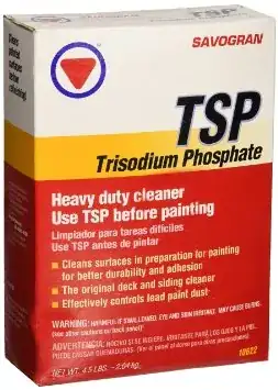

TSP and a sponge mop. Wash the walls once with a TSP solution, then again with clean water to remove any soapy residue. This stuff really works, so that means if you've sensitive skin, wear those big rubber cleaning gloves.
