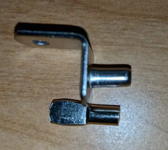

I went and found some nice 90-degree pins at the store, but noticed a small problem when installing.
The pins on the new supports are slightly longer than the old ones (old pins are 5/16", new are 7/16"). So when installed the nice L-bracket doesn't sit flush with the wall. Is this a problem? I'm guessing it should sit flush so that the wall helps the pin-hole support the weight. Pics at the end.
Should I just drill the pin-holes to be slightly deeper (assuming the walls are deep enough - these holes are on built-in shelves so it's not immediately obvious if they are) If I don't do that, should I file the pins down? Look for similar supports with slightly shorter pins? Or are they fine as is?
Pins Sticking out

    Just to clarify - the problem is the length of the pin, not the diameter. None of the pins I've seen in store or online give the length of the pin, so I'll have to check various options in person to see if any have shorter pins. – aggieTaxes Jul 23 '18 at 07:30

  • The new L-bracket pins protude 11mm. The old ones, 8mm. – aggieTaxes Jul 25 '18 at 06:10

The same shape shelf pins are available in the same size you need. The pin is measured at the part that goes into the hole, some are 5MM, some are 1/4" I have never seen 7/16" or 5/16"

  • Just to make clear, the problem isn't the diameter of the pin, which in this case is 5mm, but rather the different lengths of the pin. The pins sold in stores don't specify the length, and they just happen to be different. – aggieTaxes Jul 23 '18 at 07:33
You could add little shims to the slightly long pins. These would support the pins against the wall and keep them level. Galvanized plumbers suspension "tape" would make good shims and have holes already drilled. Or one or two washers on each pin might do the job. Then again too much shimming might make the space between the side pins too tight for the shelves to fit.
Another fix might be screws in the holes, if you don't plan to move the shelves once you have them set. Of course, if these shelves are fine wood or just good shelves in a fine shelf unit you may not want to makes holes in the bottoms. And if the shelf is heavily loaded, then such screws could have significant pull out force on them.

  • I would discourage the use of washers or other types of shims. Check carefully to see if drilling the holes deeper is an option. If not then grind the pin length down. BTW the old pins with just a 5/16" pin penetration is really not ever an acceptable type of application into particle board. I would never use short pins like that in anything but a hardwood like solid oak, ash or cherry wood. – Michael Karas Jul 23 '18 at 15:04

  • The new L-bracket pins are 11mm long. The old ones are what you are seeing in yours, 8mm. Do you have L-bracket or standard pins that are 8mm? – aggieTaxes Jul 25 '18 at 06:08

  • @MichaelKaras Thanks for the feedback. I ended up doing it the "right" but difficult way - I'm halfway through the 24 shelves, drilling the holes deeper for each shelf, drilling pilot holes for the screws into the shelves, and then screwing in by hand. We'll see if it holds up - at least I'll know if it doesn't, there wasn't much else I could do with the current setup. – aggieTaxes Jul 31 '18 at 05:58
