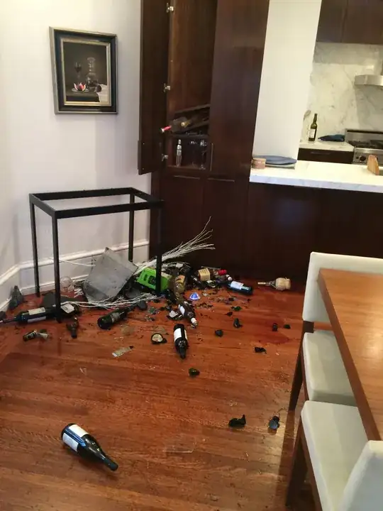

Our liquor cabinet has the usual row of holes drilled on either side for height-adjustable shelves, with typical shelf pins:
I think the wood is MDF + veneer. It might be plywood. It's not holding the pins very well.
The end result was sudden catastrophic failure followed by two hours of mopping up glass shards while trying to convince the world-famous Siberian husky who lives with us to stay in the other room.
Yes, that is a marble tabletop that actually got shattered into pieces by a bottle of Maker's Mark (recommended).
What would you use to reinforce these shelves instead of the dinky little pins?

    Did the Maker's Mark survive the destruction of the marble tabletop (looks intact in the picture)? If so, I'm more impressed with Maker's than I was to begin with... – Comintern Dec 26 '15 at 15:40
  • Normally I don't comment on posts 5 years old....but that picture is a tragedy of biblical proportions. Sad. – Steve Wellens Dec 26 '20 at 05:39

I find it hard to believe that a few bottles would tear those pins out, unless either 1) the shelves are too short, resulting in a lot of torsional force, or 2) the pins weren't fully seated. Four pins, even in MDF, should support 100 lbs. easily. Custom and pre-built cabinets around the world use simple dowels for shelf support, even in particle board, and they aren't collapsing around us.
Either condition seems supported by your photos--the wood is torn out upward of the holes. I'd do two things to reduce the repair hassle: First, be sure that the pins are seated fully. The full-round portion should not extend beyond the face of the cabinet wall.

I'm installing a shelf inside a cabinet. I was always leary of tiny pins holding a shelf. If done right with strong wood, there should be no problem. However, if the wood is weak, the shelf pins can break through the wood causing the shelf to collapse which could be disastrous like the photograph shown. I plan on using standard metal shelf brackets with 3 screw holes on both sides. The shelf will not be easily adjustable but I will have a good solid attachment that will not collapse.
