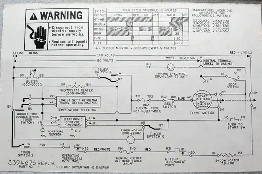

This schematic for an electric dryer might help you understand how the dryer could be wired (depending on make/model/manufacture date).
  • Actually, Tester, many modern electric dryers are built to be convertible between 3 prong and 4 prong 220. You can buy both styles of cord easily at Home Depot and swap them out with a screw driver and a hex bolt driver - 1/4 or 3/8 as I recall. – The Evil Greebo May 25 '12 at 12:37
  • @TheEvilGreebo Good to know. I haven't bought an electric dryer since 3 prong was all the rage. I knew electric ranges were this way, but didn't know dryers were too (I guess it makes sense though). – Tester101 May 25 '12 at 12:40
