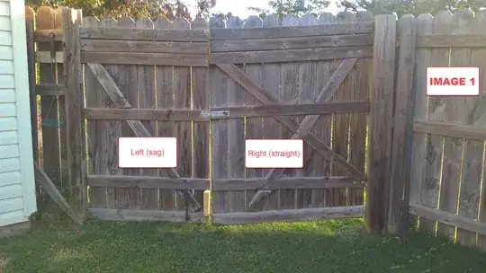

My gate used to be a single very large gate, but a local handyman cut in half about 3 years ago and made it a double-sided gate with a latch in the middle and a ground rode on one side. Both sides have cross bracing.

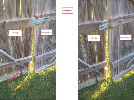

One gate has held up pretty well (Right Gate). The other gate is sagging at the top inner side (Left Gate), which is causing the latch to be misaligned and also causing a gap at the bottom which the bankyard chickens like to escape through.
Reviewing the images below, does anyone have any recommendations on how to improve the Left Gate sagging issue? Should I remove/ re-add the cross bracing? I noticed there were some gaps between the horizontal beam and the cross braces; maybe a tighter fit would help? Should I implement the "X" pattern as seen on the Right Gate? I also noticed there are products out there; they're a bit price, does anyone recommend these?
I'm not much of a carpenter or handyman, but I could get some 2x4 wood and put my straight edge and jigsaw to work on cutting some cross braces. Any suggestions would be appreciated. If you could provide photos or sketches, that would be very helpful! Thanks!

  • Image1: Cross brace design of both gates (Left=sagging / Right=stable)

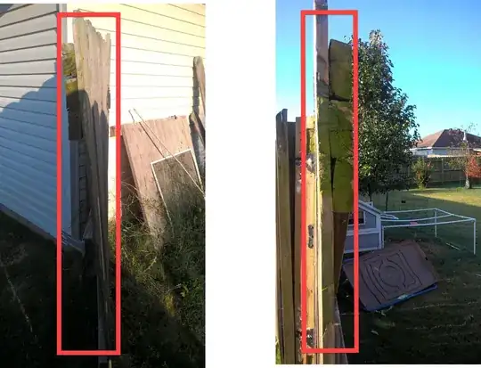

  • Image2: Ouside view of gates (Left / Right inverted view)

  • Image4: Left side angle (sag) & Right side angle (stable)

  • @ratchetfreak, I have added the photos. I think it is the gate itself that is sagging. If you look at Photo 3, the Left Gate looks look that top is drooping down. – SherlockSpreadsheets Oct 03 '18 at 18:50
  • The best way to know if the gate is sagging is to use a level. However, I've got to say that the gate in image 3 looks twisted in addition to any sagging that may be happening. Frankly, to my eye, both gates look like they're sagging based on image 2. – FreeMan Aug 20 '21 at 13:49
The left side gate is not made correctly.
The cross brace is supposed to prop up the swinging end of the gate. In other words, you want to go from the lower hinge (in this case the lower left) to the upper end of the horizontal brace (in this case the upper right).
The diagonal on the right is oriented correctly, the diagonal on the left is not.

  • Thanks for noting the optimal bracing directions. Would you suggest I remove the braces from the Left Gate? Or should I add bracing, like is seen on the Right Gate (and ends up looking like an "X" instead of a slash "\" or "/"). If I add bracing it looks like I would need to make a cut on the Left Gate middle brace, right? – SherlockSpreadsheets Oct 03 '18 at 20:05
  • @SherlockSpreadsheets - You want a "|/||\|" appearance, no need for an "|X||X|" . I personally would remove the middle horizontal piece, it's not needed, but you could cut through it sure. – batsplatsterson Oct 03 '18 at 22:15
