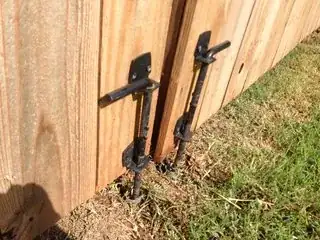

I have a privacy fence in my backyard that includes a large double gate. It was built maybe a year and half ago. The whole span is about a 11' 4" opening. The gates to meet in the middle with double hinges on each gate and a rod at the bottom of both going in the ground. There is one latch in the center (a small one I might add). The latch and rods do not adequately keep the gates from rocking during high winds (Oklahoma winds!!!) so both the bars rocked loose in the ground allowing the gates to swing even more and not stay latched. As mowing season began, I figured out I could not even open the gates because they had sagged so badly and buried the bottoms into the ground.
I had the bottoms trimmed off and the hinges raised everything back up too. This lead to a wider gap between the gates and now the latch really doesn't reach across well. Tried again yesterday and moved the latch in as much as was left to move. Unfortunately the gates are wide open this morning after a storm last night.
How should this be repaired?

  • Its unclear from your pictures, but it looks a bit like those 'gates' are just fence panels with hinges attached ... Do they have any additional bracing on the other side? – brhans Apr 27 '16 at 17:11
    please post a picture from the other side so we can see the back of the gates and the posts. – dotjoe Apr 27 '16 at 17:37
  • Is adding a post to the middle out of the question? Between where the gates meet add another metal post/4x4 with a socket into the ground. Attach some sort of latch for the gate to the post. When you need to open it wide, you can take the post out, toss it to the side. When you're done, put the post back in and latch it up. – Zymus Apr 27 '16 at 21:26
  • Your gates look *exactly* like mine, which are sagging in the same way. Thanks for asking this question. I note that you did not give a picture of the hinges. I had to increase the size of the hinges on mine, which were too small for the load. That helped somewhat. – Eric Lippert Apr 27 '16 at 21:26
    I've gotta repeat the previous comment - the most important image is on the inside so we can see the posts and framing. Post that. – JPhi1618 Apr 28 '16 at 15:47
  • You had the drop pins engaged and it still blew open? – Mazura Apr 29 '16 at 00:05
  • That fence looks pretty tall for only using 2 railings...is it 6ft tall? Also, what is the latch attached to if there is no center railing? It would help if you could take a picture from the inside. – dotjoe May 02 '16 at 18:04

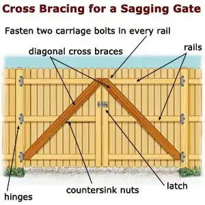

The first thing I would do is cross-brace the gate. You need to do something like this:
Cross-brace
If you Google search for "wood gate diagonal bracing" you'll get lot's of images showing the proper way to do this.

  • This used to be well known. Now people who professionally build fences don't know it? – Jasmine Apr 27 '16 at 20:57
    I'm sure people who build fences professionally know it, but that people who professionally build fences may not... :-) – Steve Ives Apr 28 '16 at 09:35
    If your having a problem with winds you should also consider more latches in the center. Perhaps http://www.lowes.com/pd_309003-37672-605556_0__ for example that you could engage during a storm. Or even spacing out the fence slats so that air can pass trough and the gate acts less like a kite. – coteyr Apr 28 '16 at 15:07

Two things are key to eliminate sag:
  • Rock-solid posts that are anchored in the ground well
  • Gates that have diagonal bracing built in
If your posts are leaning, or if they wobble with the wind, you won't be able to accomplish much. They must remain plumb, and they must be stout enough to not flex appreciably.
If your gate panels are sagging in parallax, a simple wire turnbuckle may help, or additional wood straps.
The latch isn't really part of the equation. If the other issues are resolved, nearly any latch will do.
Use a turnbuckle and steel cable. Not only will it keep the gate level but it will also torque it laterally, depending on which side you put it on. Thus, straightening it in its entirety. Luckily, the "ugly side" is the side you need to put it on.
