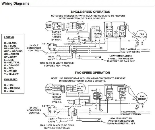

I found an installation manual for an Apollo Hydronic air handler that has a wiring diagram. The PDF of the Apollo installation manual is here and the wiring diagram is on page 8.
Any thoughts as to whether or not it would be easy to add a live "C" wire? Do I need an external transformer? Can I literally just get a transformer, plug it into a wall outlet, and connect the "C" wire to that?

In the wiring diagram in the PDF you linked, the BR (brown) wire connected to the secondary side of the transformer would be your "C" wire. It connects inside the cabinet to the pump and fan relays, and comes out of the cabinet to the A/C condensor control (along with the "Y" wire from the thermostat).

  • Awesome, thank you. I will see if I can actually understand the wiring when I get to the transformer! Appreciate you taking the time to look at the PDF diagram. – Raolin Jul 02 '12 at 03:50
  • I just wanted to say that TomG's advice was perfect. I easily hooked up an unused blue wire to the BR (brown) wire coming from the transformer and my new "C" wire works perfectly. Thanks so much for the help, I would not have ever been able to figure that out. – Raolin Aug 17 '12 at 05:28
