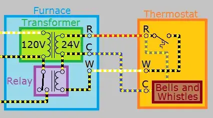

Thermostat wiring with a C wire
Thermostat wiring with a C wire showing electricity

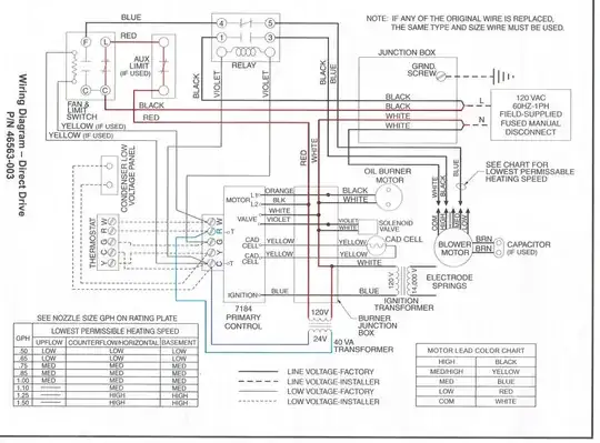

Highlighted Furnace Wiring Diagram
This is an actual wiring diagram from a furnace, but you'll notice I've highlighted a few things. First, in red I've highlighted the 120V primary side of the transformer. I've also highlighted the secondary side of the transformer in a couple shades of blue. This was done to illustrate that one side of the transformers secondary winding (light blue), is attached to the R or power terminal. While the other side of the secondary winding (dark blue), is attached to the C or "neutral" terminal.
Locating transformers
On a schematic
On a schematic or wiring diagram, a transformer will look something like this.
Transformer Symbol
Often you'll see a number written on each side, which denotes the expected voltages on each side of the transformer. Notice in the schematic above that the top side lists 120V (120 volts), while the bottom lists 24V (24 volts).
