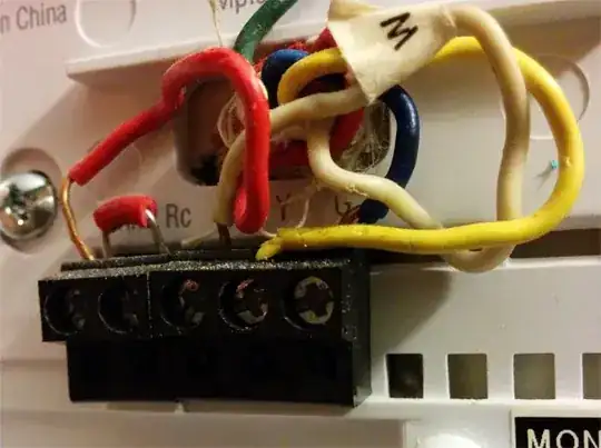

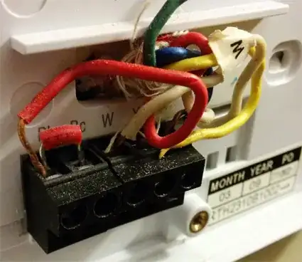

  • What type of heating system do you have? What type of cooling system do you have? Are they 2 separate systems or one? Your diagram implies separate but your thermostat wiring implies a single transformer system. Your wiring diagram shows 4 wires connected at only one end. It shows a green wire connected to Rc on the thermostat but there's no wire connected to the Rc terminal in the photo of the thermostat wiring block. Just the jumper wire from Rc to Rh which you may not need for your system. The video you linked to is for single heat systems. I hope you didn't try to follow it. – OrganicLawnDIY Dec 23 '13 at 01:50

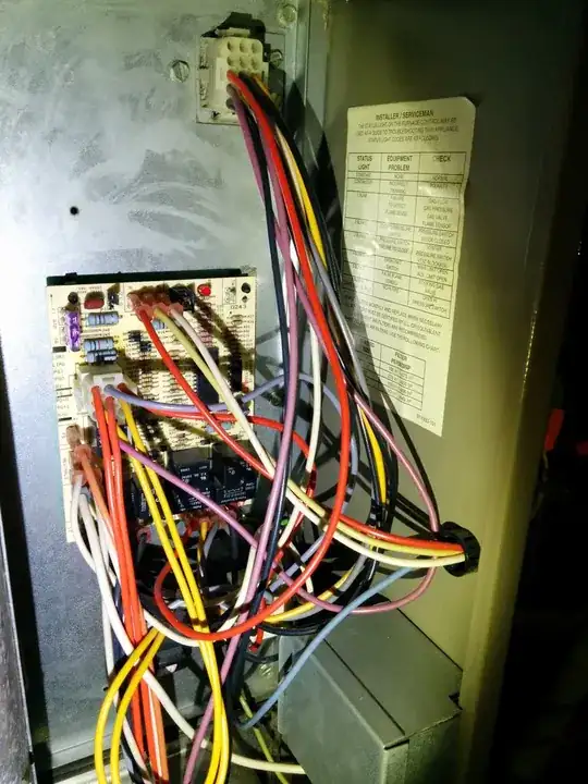

  • Maybe it's time to call in an HVAC technician. In the first image of the furnace, the red wire goes to a terminal on the board labeled `R`, the yellow goes to a terminal labeled `G`, and the white wire goes to a terminal labeled `W`. The blue wire goes somewhere we can't see, but I'm guessing it's a terminal labeled `C`. Also, it would be helpful if you included the make and model number of the furnace. – Tester101 Dec 23 '13 at 10:56
The C-wire substitution requires you to use the G-wire. When using the G-wire as a common you have to change it to C at the thermostat, and then to a common in the bottom panel of the unit. In your situation, your specific unit uses an older style control board made by White Rogers. This early revision of the board did not have a terminal bus on the board the thermostat, air conditioning, and fan speed 24v connections. Wires were used instead if a terminal bus, and only has 4 connections (your W, G, R, Y wires). To have your new thermostat work, you will need to remove the thermostat wire at the unit. Then you must either ground it to an exterior panel of the unit, or using spade, attach it to one of the open neutral buses on the control board. After doing this and adding the G-wire on C at the thermostat, it will work fine.
