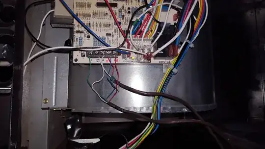

I'm upgrading from a White Rodgers thermostat to Honeywell RTH9580WF. The Honeywell requires a C wire. My old White Rodgers thermostat does not have a C connector. It has a wire from the air handler switchboard to the thermostats RC and is has a jumper to RH.
(air handler) - (Thermostat)
W - W
Y - Y
G - G
R - RC jumper to RH
I can see on the air handler that there is a COM 24v which I believe is C (COM = Common = C, right?)
There is a second 18/4 wire hooked into the air handler (C & Y). I'm not positive where that line runs, but it looks to follow the coolant line, so maybe to the condenser outside?

Run a new cable with at least five conductors. Connect a wire between COM 24V, and the C terminal on the thermostat.
The cable that connects to Y and COM 24V, goes out to the outdoor unit.
If the indoor unit only blows air, and doesn't add heat. It's called an air handler.
Since you have an air handler and not a furnace -- I bet W does nothing whatsoever. Unhook that wire from W and connect it to COM 24V at the furnace end, then use it as your C wire for the new 'stat. And yes, the cable from Y and COM that follows the refrigerant line goes to the condenser unit outside.

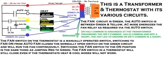

RC and RH on the thermostat mean Red Cool and Red Heat, this is for old General Electric HVAC equipment that had 2 transformers 1 for Heat and 1 for Cool. The Transformers 24 volt hot leg from the AC unit went to RC and the 24 volt hot leg from the air handler went to RH and there was no jumper between RC and Rh, today's modern HVAC equipment uses 1 transformer for both modes Heat and Cool thus the jumper between RC and Rh the red wire can be attached to either since they are jumpered together
