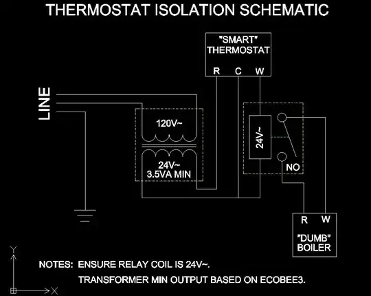

Yes, definitely can be done. My boiler kept rebooting my Ecobee3 (not sure if it was a power spike or drop, concerning either way), so I built an isolation module for it. It isolates both the power and W signal.
Works perfectly now, but I might test all the on-boiler 24V~ components if I have time, just in case the restarting was a symptom of another problem.
The following schematic is basically longneck's instructions with RMan's edit:

A simplified version of a thermostat schematic, might look something like this...
Thermostat Wiring
To power the thermostat from an alternate power source, you'd have to modify the circuitry so that the additional features were isolated from the control portion of the thermostat.
Thermostat with alternate power source
If you absolutely have to run a separate power source, all you need is another relay, like this one: http://www.jameco.com/1/1/46908-t92p7d22-24-24v-general-purpose-industrial-power-relay.html
  • Connect the power source to the thermostat R and C wires.
  • Connect R on the thermostat to one of the coil terminals on the relay.
  • Connect W on the thermostat to the other coil terminal.
  • Connect the original R wire to the common terminal on the relay.
  • Connect the original W wire to the NO terminal on the relay.

  • I think that the 2nd line in the list of the previous response is not correct. Instead of "Connect R on the thermostat to one of the coil terminals on the relay", it should be "Connect C on the thermostat to one of the coil terminals on the relay". The relay coil needs to be powered by 24V if activated (calling for heat), which is done by the W wire (which has the 24V on if the thermostat calls for heat) and the C wire for the return of the 24V. This worked for me. –  Oct 13 '15 at 00:11
