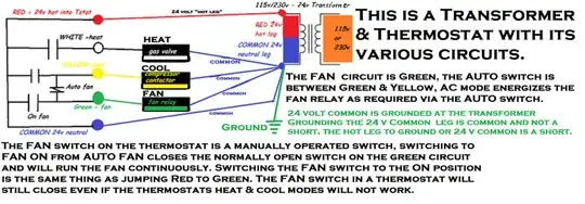

Common leg of the 24 volt control circuits is grounded, Red is not. Common is the side of 24 v power that every 24 v circuit terminates to complete its circuit.
