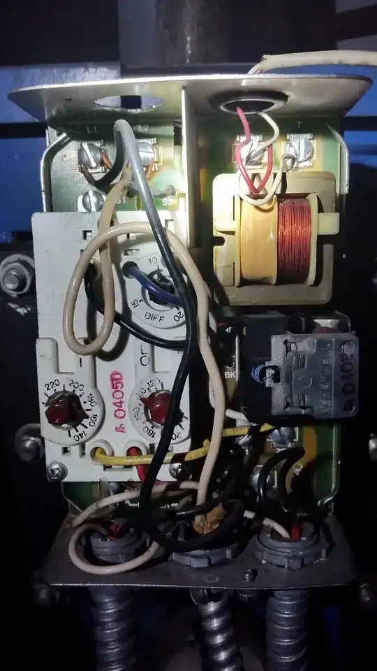

The new thermostat I purchased doesn't run on batteries, and needs 24 volt power. I have only a red and a white wire connected between the boiler and the thermostat, but there is also a third, unused wire. The instructions from the thermostat say to hook that third wire to the C terminal on thermostat and to the furnace's C, but I have a boiler with no C. Where do I put it on here? Please help I'm desperate.

Unfortunately, the Aquastat you're using does not expose a C terminal. The transformer is likely soldered directly to the board; so unless you're good with a solder gun, you're going to have to buy a different thermostat.

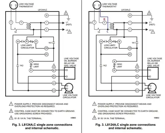

If you're not afraid to potentially break things, and you really want to try to get the new thermostat working. You could try to add your own C wire. You'll simply have to connect the new C wire, to the other lead of the secondary coil of the transformer.
Left image shows original wiring. Right image shows where the C terminal should be added.

If those red and white wires are wired correctly, the +24v 'R' terminal should be the red wire in the upper right, that is under the 'T' screw. Do NOT mess with either of the (12g) wires in the upper left, under the L1 and L2 terminals. Shut the power off to the unit before you go poking around in there.
The C terminal you're after does not seem to be user accessible; it would be one of the solder joints on the back of the circuit board the transformer is mounted to, as old boiler controls weren't designed to supply auxiliary 24v power. I'd have to ask if it is OK to achieve a low voltage ground by attaching it to the control box with a screw. I lack the experience necessary (and the schematic/number for this control) to even attempt to say one of the other terminals on it might work for you, safely.
This doesn't make any sense to me, the thermostat just shorts out the transformer after it goes through a resistor. (top left)

  • The back of the old thermostat has a red wire going to the RH and the white wire going to the W. The photos above are of my Aquastat L8124A. So just connect the unused green wire to the same terminal as the white and then on the back of the new thermostat put it in the C spot? – Mike N Oct 29 '14 at 22:43

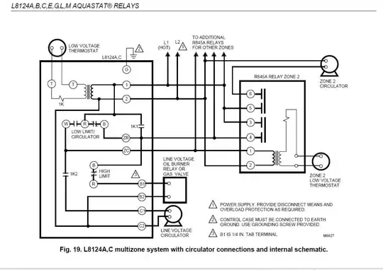

  • i have 2 zones but yes from what i can tell they are correct Henry. Any ideas what to do? – Mike N Oct 29 '14 at 22:55

  • Without verifying it with a tester (that it provides 24v to ground), I"d guess it's the T terminal with the RED wire. Henry was correct, I was wrong. The white wire is not C, it is merely a switch leg. I am unsure if you can just ground it (the green wire) out to the control box of the boiler, and attach it to C on the thermostat. You need access to the other wire off the secondary transformer coil, which will be difficult with it mounted on a board. – Mazura Oct 30 '14 at 00:07
  • You have +24v, (R), what you don't have is a ground return, (C). @MikeN – Mazura Oct 30 '14 at 00:36

    @Mazura the little zigzag labeled 1k is a coil, not a resistor. – Tester101 Oct 30 '14 at 12:16
  • @Tester101 The board shows S1 and S2 and they look jumped...? – Mazura Oct 30 '14 at 18:08
  • @Mazura Not S1 and S2 on the board. I meant the Secondary 1 and Secondary 2, you know on the transformer. Where P1 and P2 are the primary contacts, S1 and S2 are the secondary contacts. – Tester101 Oct 30 '14 at 18:44
