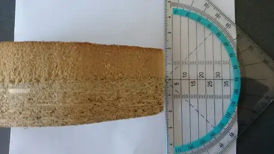

We have a pitched roof (1971 house, The Netherlands) which consists of (outside to inside):
  1. Tiles
  2. 2cm PUR insulation
  3. 2cm wood
We asked a few companies for quotations to improve the insulation (currently Rc=0.8).
Company 1 is suggesting to add rockwool to the inside, while company 2 says that any insulation on the inside will lead to condensation issues.
Are there any options for adding insulation on the inside of the roof in this case?
Edit: picture of the roof material: Picture of the roof material

  • I have added a picture to the post of a slice of the roof (on top are the roof tiles). – Ruben Jul 21 '19 at 08:46
