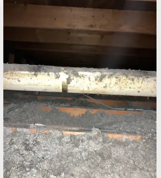

Approximately 20 years ago the roof and attic had significant work done, including blown in insulation the floor of the attic crawlspace (reference picture for a general idea of what it looks like). I don't know the R value offhand for this insulation. The attic is (theoretically) passively ventilated, and others have told me that there is rigid insulation in the roof assembly as well.

Picture of crawlspace with loose insulation

  1. Additional blown cellulose insulation is VERY cheap and based on the pic, it should be done.
  2. I don't recommend a box fan. Increase the ventilation and use proper fans that are designed for that space. This is not terribly expensive generally.
  3. It is possible to put reflective material on the roof to reflect the heat.
I would start with the blown insulation as that is a weekend project. Easy and hard to mess up; just don't block soffit vents. Adding additional ventilation is the next step I would take; if you can move enough air, you can keep the attic quite close to outdoor temperature.
