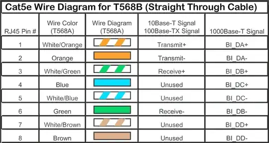

The telephone wires in your house have 3 twisted pairs. Ethernet is usually ran with 4 twisted pair wires. However, for 100Base-TX, 2 of those twisted pair wires aren't used as only the orange and green are used for transmit and receive. The blue wires are used for Power Over Ethernet. From your pictures, you should be able to wire a RJ-45 Keystone Jack with all 3 pairs of your wire.
Cat5e Wiring Diagram
Basically, you'll need to take your orange, green, and blue wires and connect them to the terminal on your RJ-45 jack on each floor. On the middle floor, where you have 2 wires, you'll need 2 keystone jacks. Then, you'll need to put an ethernet switch in the middle floor and connect both the top and bottom floor (along with the middle floor). If you're only interested in connected the top and bottom floor, you can put in a small 6" patch cable to connect the top and bottom floors together. Obviously, you'll need to remove your telephone jacks to replace them with the RJ45 keystone jacks mentioned previously. While this solution isn't the fastest, it take minimum effort to get up and running.
