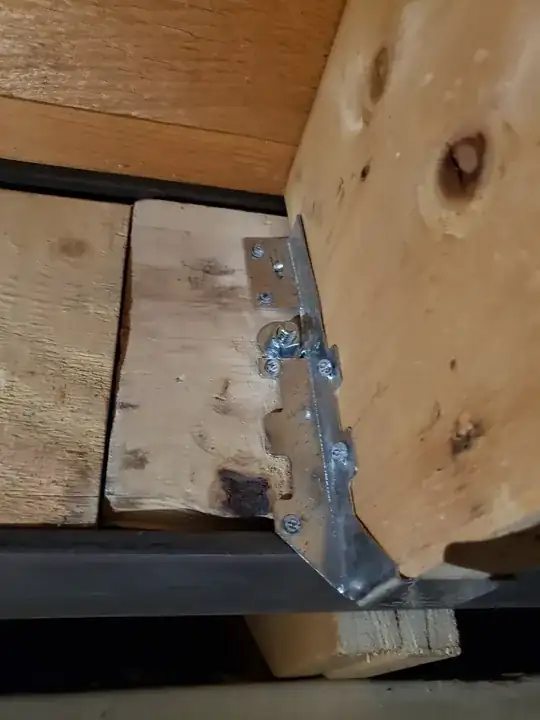

We are removing a couple of load bearing walls as part of renos in our home. The engineer specified a W8x21steel beam to replace the load bearing wall. The floor joists are 2x10.
It appears the contractor put the bolts into the "header" (not sure if that is the right term) in the wrong place (not enough space between bolt and joist). He then cut some of the joist hangers to make them fit. This has been done in at least 4 out of the 10 hangers that he has installed.
Also, he used 2 1/2" layers of plywood plus a 2x8 as a header in the flange of the steel beam (see picture below)
Questions:
  1. Has the integrity of the hanger been compromised by him cutting out part of the material?
  2. The hangers he used are Simpson Strong Tie LUS210Z. Are these the correct hangers to use in this application since the beam is shorter than the joist by 2" and the lowest nail barely goes into the wooden
  3. The contractor has used N10dhdg Simpson nails (.148" x 1 1/2"). Are these the right nails to use? The Simpson website specifies that common 10d nails (.148" x 3") are used with this hanger.
  4. Is the use of plywood + 2x8 as the header acceptable or should this be replaced with a single 3x10 cut to size? Should we use 2 1/2" nails into the header?
Per the simpson website https://www.strongtie.com/facemounthangersssl_solidsawnlumberconnector/lus-hus-hhus-hgus_productgroup_wcc/p/lus.hus.hhus.hgus
"With 3x carrying members, use 0.162" x 2 1/2" nails into the header and 0.162" x 3 1/2" nails into the joist with no load reduction. With 2x carrying members, use 0.148" x 1 1/2" nails into the header and 0.148" x 3" nails into the joist, reduce the load to 0.64 of the table value."
Is this ok and if not any suggestions on how it can be corrected?
Thanks! Added view of header inserted into i-beam enter image description hereenter image description hereenter image description hereenter image description here

    Considering the specs on the nail size. The floor joist's size of 2x12 is what is known as nominal unless they used a "true" 2x12 which I highly doubt. The actual thickness is closer to 1 1/2 inches so driving a 3 inch nail into 1.5 inches of wood isn't going to help anything. The board which is perpendicular to the floor joist looks to also be 1.5 inches thick so if you drive a 3 inch nail then it will hit the steel and be unable to go further. I cannot speak for the integrity of the notched hangers but that bottom nail appears to be driven into air unless it is angled upwards. – MonkeyZeus Sep 06 '19 at 12:52
  • [Nominal vs Actual](https://www.archtoolbox.com/materials-systems/wood-plastic-composites/dimensional-lumber-sizes-nominal-vs-actual.html). I would imagine that an inspector would say to [drive additional nails](https://i.stack.imgur.com/Aq5p1.jpg) and call it a day but I'm not an inspector nor an engineer. – MonkeyZeus Sep 06 '19 at 12:58
    Agreed on only use 1-1/2" for straight nailing, however diagonal nails are spec'd at 3" I believe. A 1-1/2" diagonal nail will barely protrude from the 2x12. – Technophile Sep 06 '19 at 13:42
    The right move would've been to countersink the nuts and cut off the bolts flush with the ledger. Fortunately it's easy to replace the hangers. – isherwood Sep 06 '19 at 14:30
  • Just to follow up on my comment. Yes, 3 inch nails should be used for the diagonal nails. – MonkeyZeus Sep 06 '19 at 16:18
  • So, your contractor seems to have cut some corners - and not just in the hangers. ( ... sorry, couldn't resist the pun.) – einpoklum Sep 07 '19 at 21:52
    @isherwood That's one way. A much better way would be to drill proper clearance holes in the hangers for the threads, so the nut tightens directly down on the bracket. – Mike Waters Sep 08 '19 at 00:51
    @Mike Waters better talk to the building inspector first. If you were an engineer and people wanted carte blanche to cut and modify joist hangers, who knows what they might do. Perhaps resulting in floors falling. Which is why building codes do not allow modifications to joist hangers, at least not without an inspector's permission. – Technophile Sep 08 '19 at 16:45
    The more I look at it, the less I like the butt joint in the 2x8 (first pic). Did the engineer allow it? Have you spoken with him/her yet? You need to. – Technophile Sep 08 '19 at 16:51
    Lots of upvotes for a suggestion to drill holes in a hanger. I'm a bit baffled by that, and I disagree. No modification is safe without manufacturer approval. – isherwood Sep 09 '19 at 01:50

No, it’s not acceptable to cut the joist hangers.
In order to determine if they are acceptable anyway, there are several issues to review: 1) hangers are notched, 2) incomplete nailing, 3) wrong nails, 4) wrong install of fasteners (angled install in lieu of perpendicular to joist installation).
1) Notching the hangers voids the allowable stresses published by the manufacturer for each hanger. However, if the hanger is not stressed to its maximum allowed, the engineer can review and determine if it meets the “intent”.
2) 3) and 4) Published allowable stress values are determined by installing the hanger in the proper manner, as per the manufacturer’s installation instructions. When the fasteners are not correct, missing or improperly installed, then the designer will need to make a determination that they meet the required design loads.
If you have a Building Permit, I’m sure the Building Official will want the designer to provide “certification” that the installation is acceptable. If it’s not acceptable, it will need to be re-done.
So, if the correct wood ledger was used and it’s impossible to comply with the drawings, the engineer will need to redesign...and pay to have it done correctly. You can see that the engineer will do everything possible to accept the lack of nailing fully into the ledger/beam...but will probably want the hanger replaced (at the contractor’s expense).
It’s important to you to get this corrected or have the engineer provide the certification, because if there’s a problem in the future, they’ll both point the finger at each other and you’ll be in court forever.

    How do you propose driving 3 inch nails into 1.5 inches of wood with steel behind it? – MonkeyZeus Sep 06 '19 at 13:11
    @MonkeyZeus the diagonal nails need to be 3". 1-1/2" will barely protrude from the end of the 2x12. – Technophile Sep 06 '19 at 13:44
    @MonkeyZeus Simpson makes “short” nails, but they also allow “double shear” nailing. Here’s a chart showing their nails available: https://www.strongtie.com/products/connectors/wood-construction-connectors/technical-notes/fastener-types-and-sizes The contractor could have used the short nails into the wood member fastened to the steel beam and 3” nails fastening the joist to the hanger. – Lee Sam Sep 06 '19 at 15:57
  • @Technophile Yes, the diagonal nails should be 3 inch. – MonkeyZeus Sep 06 '19 at 16:16
    I wouldn't want any diagonal nailing when it's in the same direction as the forces on the nail. That's a disaster waiting for the nail to walk out. I would also think a joist like this would need to be attached to a double thick header or a 4x, which would accommodate the 3" nail, and what I think the hanger manu. expects. I would also think the hanger is supposed to be attached to the same or wider width board as the joist. With the header being smaller dimension, this seems like a totally botched install. – computercarguy Sep 06 '19 at 16:33
    I am inclined to agree on wanting more than a 2X to anchor into. However on the diagonal nails (is this a misunderstanding - diagonal should be sideways NOT angled up) I refer you to the manufacturer's (Simpson Stong-Tie) website: https://www.strongtie.com/resources/product-installers-guide/lus-installation. – Technophile Sep 08 '19 at 16:35

Cutting a hanger is never a good idea and should never be accepted. It's shoddy workmanship by the contractor and there were numerous solutions that could have avoided this (starting with properly measuring the bolt locations for the web blocking). However, the main issue is that these hangers are not designed for this application. They are meant to hang joists from solid sawn wood beams, typically 2 or 3 2x members in a laminated configuration. These can also go into a ledger designed for them, but web infill blocking. Is not typically designed for this for a number of reasons. Simpson makes top flange mount hangers that should have been specified instead (whether by the engineer or the contractor) and either welded or pinned to the steel since that is the actual structural member. Sounds like your contractor should be to blame for most of this in my eyes, although the engineer certainly could have done better as well.

You never cut hangers unless they are made for cutting. Call in a inspector who will advise you or the engineer who done the design but don't under any circumstances let this go without it being checked. As further down the line could cost you a lot of money.
  • Hello, and welcome to Home Improvement. Thanks for the answer; keep 'em coming. And, you should probably [take our tour](//diy.stackexchange.com/tour) so you'll know how best to contribute here. – Daniel Griscom Sep 06 '19 at 15:56
I'm familiar with that double shear hanger. Nails should be 10d 3" for the cross nailing and 10d 3" or 10d 1-1/2" depending on single or double 2 x material rim joist/header. However it's the wrong hanger for the application. It might have been ok if the rim/beam/header was constructed differently. And never modify a framing hanger other than bending those meant for it. The through bolts should have been laid out to avoid conflict with the joists.

    How are they the wrong hanger? You don't make that clear. – isherwood Sep 06 '19 at 14:31
  • @isherwood please have a look at the Simpson Stong-Tie website. Framing connectors have specific approved applications, based on mechanical engineering analyses and testing. Framing construction is regulated via building codes, permits and inspections because people can die (or at least sue) when houses fall down. Construction can look simple, and there are many who will happily wade in with a hammer, saw and little skill, knowledge or understanding. – Technophile Sep 08 '19 at 17:13
  • Thanks Rick and everyone for all the responses. Rick, can you please explain which hanger would be more suitable? Is the issue with the current header that it is only 2x8 with 2 layers of 1/2" plywood? Any suggestion on what can be done to rectify? For the bolts should the existing bolts be moved to a different location or should the existing joists be sistered? – user105375 Sep 08 '19 at 17:44

It appears to be horribly wrong. The hangers should not be cut but this is the least of your worries. For starters, the steel I-beam is shorter than the joist it's intended to support. The bolts connecting the wood header to the i-beam are undersized. The wood headed bolted to the I-beam is shorter than the joist it is intended to carry.
There are a few ways to correct this:
  1. You can use Simpson's top mount joist hanger and use the I-beam to support the joists. This would require gaining access to the top of the I-beam by removing the subfloor (and any finished floor) above.
  2. Depending on the condition of the wood header inserted in to the I-beam you may be able to add another header to the one you have. The new header should be the same size as the joist, and must be laminated and bolted to the I-beam with no less than 3/4" diameter bolts spaced 2' apart in a top and bottom pattern to prevent splitting. Keep in mind that the bolts are carrying the load of the joists and must be strong enough for this. After this is done, install the face mount Simpson hangers. Use Simpson #10 x 3" screws where you can drive through both the original header and the secondary header. Otherwise, use Simpson's #10 x 1½ screws.
  3. If you're able to get to a lumber yard, you may be able to get a 3" x 12" wood joist and use this in place of the header that's affixed to the I-beam. You would have to notch a section of the 3 x 12 joist so that it can fit into the I-beam while still keeping the 12" width on the outside of the I-beam. The 3 x 12 must be bolted the same way as in option 2 above and the perpendicular joists can be face mounted with the same screw detail as in option 2.
There's one or two other options but these three should be the least complicated to achieve.

  • Thx for all your responses. Our engineer has asked the contractor to move the bolt locations so that they don't interfere with the hangers. For the hangers he wants to use LRU28 instead. We also checked with Simpson and they confirmed that LRU28 can be used in our case but recommend that we use SD10x1½” screws into the face flanges and SD10x2½” screws through the double shear joist fasteners. Question: A few joists are not sitting flush with the beam and have as much as a 1/2" gap at the top and 1/4" gap at the bottom between end of joist and steel beam. Any concerns with this spacing? – user105375 Sep 18 '19 at 11:26
