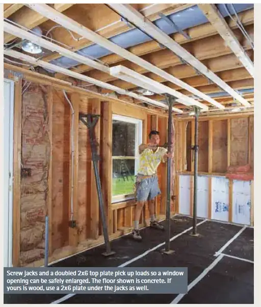

Just a note that shoring the ceiling while you make the wall/stud modifications is non-trivial business in itself. From Litchfield's Renovation, you have a couple of options, using screw jacks or even an entire temporary stud wall, parallel to the one you're hacking. The latter is probably overkill for what you're doing, so I'm only illustrating the screw jack method:
proper use of screw jack to support overhead joists
You may end up having to repaint the ceiling and/or even fix its drywall due to the potential damage to the ceiling finish from the jacks.
