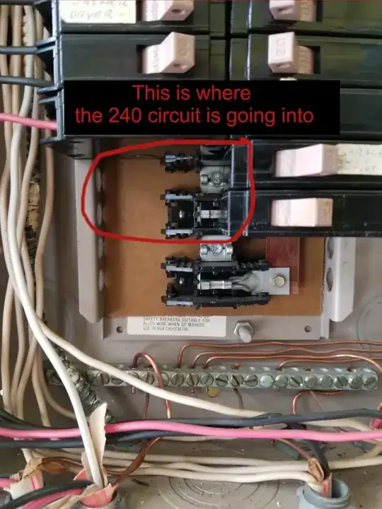

**Update I have changed it to a 4 wire 4 socket outlet and plug. I am still only getting 120 from hot to neutral but not 240 from hot to hot. Here are some images of my setup.
Dryer Electric Box Circuit Area Second Bar Outlet Cord
***Update I Measured the voltage on the screws near the factory installed as Nate asked. When I did the the two screws next to factory installed it gave me nothing but when I did one screw at a time with the top neutral line coming in I got 120 Volts on each one. Does that mean I am only getting 120 volts to the box? I also noticed this on my meter that it says 120V 2W. I wasn't sure if that meant 120 for each wire or the 2 wires equal 120V enter image description here

    Shoot us a photo of your service panel breakers, and also if possible the wiring of the dryer socket. Does this circuit have ground? – Harper - Reinstate Monica Nov 13 '19 at 20:11
  • @bosestron, your update with the pictures is helpful, thanks! You're correctly using a 2-pole breaker, so there must be something else going on here. One possibility is that this entire panel is fed from only a single leg, making it a 120V-only panel. Can you measure the voltage between the incoming feeders (i.e. on the screws near where it says "FACTORY INSTALLED")? – Nate S. Nov 18 '19 at 21:34
  • Also, is this a main panel, or a subpanel? If it's a subpanel, can you post some pictures of its breaker(s) in the panel it's fed from? – Nate S. Nov 18 '19 at 21:36
  • Can you post a close-up of the breaker for the dryer? (It can be detached from the panel when you do this) – ThreePhaseEel Nov 19 '19 at 02:04
  • Yes, is this your main panel, or is there another panel somewhere that lets you turn the power off to this one? Also, where are you on this planet, and who's your electric utility? – ThreePhaseEel Nov 19 '19 at 04:16

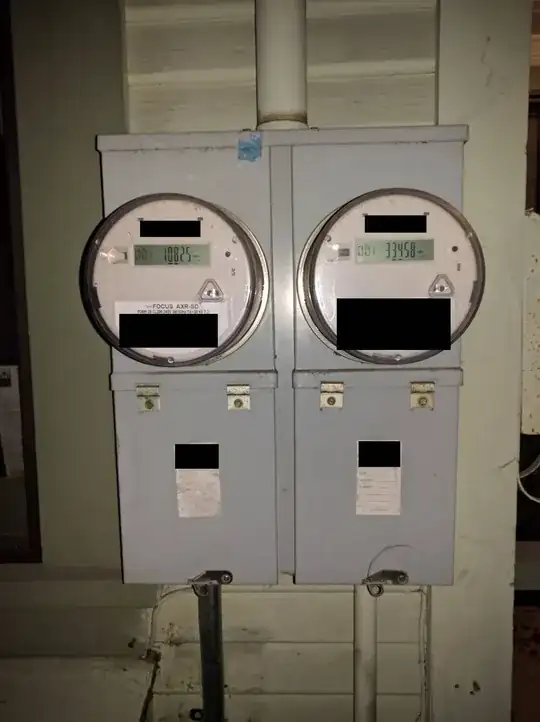

You've got 120V service, not 240V
As you have found out through the "hot to hot = 0" testing, you appear to have 120V service, not 240V service.
That is rather unusual, though not unheard of. But it severely limits the amount of power you can use. Based on a first look at your panel, you would expect to have 100A x 240V = 24,000W. But instead you sort of have 100A x 120V = 12,000W. But it gets a whole lot messier than that.
The meter picture is the key to determining that this is indeed 120V service rather than 240V service connected wrong. In fact, there have been some questions about how to deal with a single hot out due to various reasons, and temporarily connecting both hots on the panel to a single service hot can be a solution (provided it is done in a safe way). But in this case your meter really is a 120V meter. If you look at the information about this line of meters there is a chart listing 120V 2-wire and 240V 3-wire meters - your meter says "120V 2W".

Paralleling Conductors
You have an interesting problem because instead of connecting the single hot and neutral (= two wires = 2W on your meter, which is normal for 120V), you have 3 wires - two hots and a neutral - connected to the panel as if it was 3-wire 240V service. The result is confusion (as you know) but also possibly a dangerous situation with paralleling conductors. You have 100A x 2 wires. But instead of it all going to one place, it goes to 2 breakers (in a pair, but they are still really 2 breakers) and the power is divided up on the panel bus.
The result is that you could actually pull 200A, if the loads are well balanced, without causing a trip of your main breaker! That would normally be fine - 100A x 240V. But in your case it would really be 200A x 120V. That would be OK for the hot wires. But it would absolutely NOT be OK for:
  • The meter and wires from the meter back to the pole - they are all sized based on 100A service.
  • The neutral wire - it is only sized for 100A. With 240V service, the most it will ever have is 100A. In fact, if you have 100A x 240V in use then the neutral carries no current. But with 120V, that one neutral can end up carrying a full 200A, which will cause it overheat, which is not a good thing.
Talk to your Electric Utility
The power company is the only one that can truly solve the problem by upgrading you to 240V service. Properly installed, that will solve your dryer problem and give you a lot more power to work with for other things too.
If that just can't be done - either 240V service is not available or you are on a subfeed from somewhere else (e.g., one of a pair of houses, each getting a single hot from a 240V feed) then some changes to your panel are in order. The simplest safe thing to do would be to switch the 100A main breaker for 50A. However, that would be limiting because if your load isn't exactly balanced (and it rarely is) you might find that you trip the breaker even when using far less power than 100A. Another alternative is to only use one hot in the panel. That is easy to do - just use alternate rows. However, you will run out of spaces to connect all your loads so then you would need a larger panel that would be half empty.
    Yeah, that meter is a Form 1S, which is a surefire giveaway that their service is 120V-only :/ – ThreePhaseEel Nov 19 '19 at 05:06
  • Thank you for the info. That is what I was afraid of when I saw the meter. – bosestron Nov 19 '19 at 11:45

Your breaker must be a 2-pole not a duplex
... and it will not fit in one slot (space).
Fair chance you have a "duplex" or "double-stuff" breaker, with two handles. The breaker fits in one space. The dead giveaway is that the handles throw independently from each other, which means it is absolutely inappropriate for a dryer. Dryers need a breaker with common throw on the handles, and also a feature called "common trip" which assures both sides trip at once.
Further, dryers need a 240V breaker. By definition, a 240V breaker must span across two "spaces", or it wouldn't have 240V!
HOLY SMOKES! You have a much bigger problem here than you thought!
Somehow, between your electric utility and whoever wired your house, something didn't get communicated correctly, and the results are frankly, a hot mess. Your utility provides a 120V, 2-wire, single phase service to your house; this is shown both by the voltage readings you are getting at your main breaker, and by the fact that your meter is Form 1S (look below the right end of the long line of text, and it says "FM 1S" on the second of 3 short lines of text there), which is what is used for a 2-wire service like yours. (A normal 3-wire service uses a Form 2S meter, by the way.)
However, whoever wired your house wired it as if they had a normal, 120/240V, 3-wire, split-phase service coming in; we can tell this both from the undersized service neutral coming in (for a 100A service, normally, the neutral will be the same size as the hots, but Code allows it to be smaller than the hots on a split-phase service for reasons that are explained below), and the fact that they made extensive use of multi-wire branch circuits when wiring your house (I count 5, not including your new dryer circuit).
The reason this all is a problem is because in a 3-wire, split-phase setup, service and multi-wire branch circuit neutrals only carry the difference in current between the two opposite legs of the service or circuit. This is useful, because it lets us save wire, and also downsize service and feeder neutrals if large load imbalances are not expected, as normally, single-phase branch circuits are roughly balanced across phases/legs by the layout of North American loadcenters/panelboards, where no two directly adjacent spaces are on the same phase or leg.
However, if you accidentally connect both legs or phases of such a split-phase service or circuit to the same leg, as whoever wired your house did when they connected the service-entrance conductors to the meter base, not only will you not be able to get 240V out of the circuit or service as you expected, but the current flow in the two hots has only one way to get back to where it came from, and that's the single neutral, which is now carrying twice the current. Since neutrals don't have circuit breakers (they're assumed to be protected because their corresponding hot wires are protected), this leads to the neutral wire slow-cooking itself whenever the circuit is heavily loaded, and eventually your house as well!
This gets worse when you have a service that is wired with an undersized neutral, only meant to handle load imbalances. Now, you have a neutral wire that is already too small for 100A, trying to handle up to 200A of current, before the main breaker in your panel will ever notice anything is wrong!
Fixing this will require your utility to help, so call them NOW!
Since this problem is an issue with the service to your house, you will need your utility to intervene, at minimum to pull the meter so that the service wiring can be safely replaced with something that can handle the situation it's been placed in. Furthermore, while the service-entrance conductors and service disconnecting means in your house technically comply with the letter of NEC 230.42(B) and 230.79(C), the installation as a whole does not comply with the NEC. In particular, using a 120/240V, 3-wire distribution panel with a utility-supplied 120V, 2-wire (Form 1S metered) service is forbidden, as if it were allowed, NEC 710.15(C) would then be superfluous:

As a result of this, I would be seriously asking the utility to get you on a proper 120/240V, 100A, 3-wire (Form 2S metered) service, as that would simplify things greatly, requiring only a new 10/3 run for the dryer circuit (to handle the full load of your dryer) and some handle-ties in the panel (to make it so the MWBCs have common maintenance shutoffs, as required by Code). If your utility refuses to upgrade your service, not only will you need to switch your dryer back to 120V, you will need to have the house rewired to rid it of the multi-wire branch circuits!
