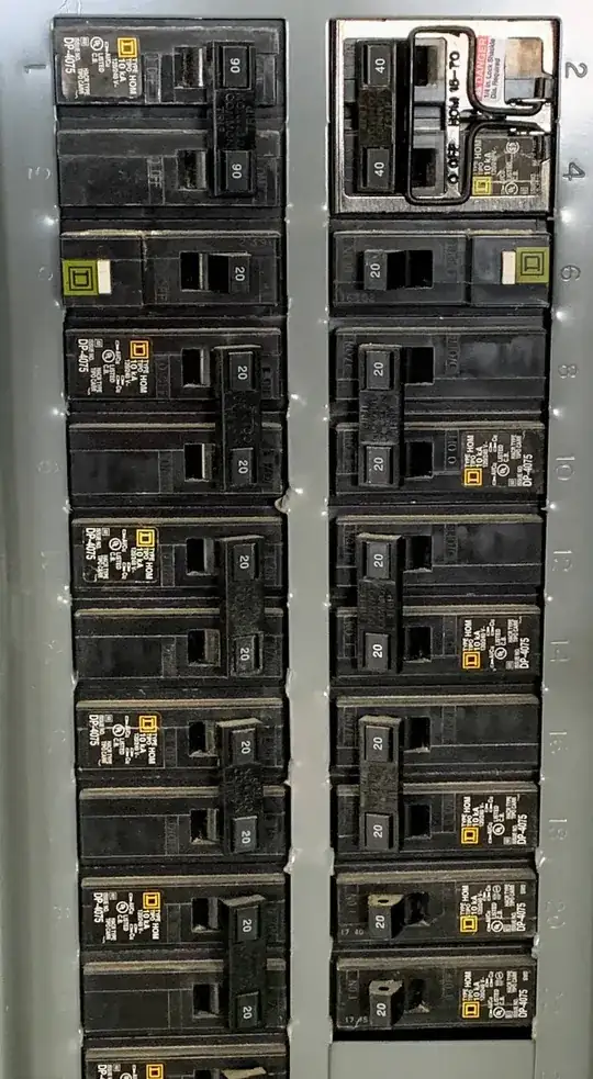

I'm looking at electric panels in some newer residences and seeing something confusing: Circuit breakers that are adjacent to each other, but that cover unrelated circuits, are ganged, as shown below. By "unrelated circuits" I mean circuits that have no reason to trip or switch together. For example, "Master Bed Lights" and "Living Room Outlets" are adjacent and ganged. So are "Bath GFCIs" and "Office Outlets." (And then there are a few adjacent breakers that are not ganged.)
Is there some code or other reason for ganging unrelated breakers like this?
Breaker box

They are Multi-Wire Branch Circuits
This is a wiring strategy that depends on North America's system of having "neutral in the middle" of 240V, giving two legs of 120V.
A circuit can be wired so that it brings out both legs, giving a single circuit which is effectively two 120V circuits which share a neutral and ground.
This provides a savings in wire, at the cost of complicating use of GFCI and AFCI devices.
This makes even more sense when the outlets are far from the panel, both for the savings and because MWBCs have less voltage drop than single circuits. It appears this builder also gave you a wire size bump above the mandatory #14/15A... allowing 20A breakers; single 12/3 was cheaper than dual 14/2. And more useful, nuisance trips notwithstanding.
Breakering an MWBC
Since it is in fact one circuit, it needs one maintenance shutoff. Otherwise, a person might plug a radio into one half of the circuit, flip off breakers until the radio goes silent, declare the circuit "cold", and then go get nailed by the other half of the circuit. For this same reason, 2 independent circuits need to be handle-tied when they service the same receptacle. Who checks both sockets??
What it does not need is common trip. Note that these are actual, proper 2-pole breakers; those have internal mechanisms which guarantee common-trip, which is appropriate for dryers and ranges. On a MWBC, it's perfectly acceptable to use two independent breakers and a factory Handle-tie (not a nail). Handle-ties do not guarantee common trip, but realistically, it will probably happen. So don't waste money switching.
If you do any work with MWBCs, you need to follow some special rules, such as pigtailing neutrals instead of using a receptacle as a splice block.
It shouldn't be an inconvenience
Because you shouldn't be tripping breakers much. If you are, then the root problem is a lack of a sense of how much load a circuit can support. Review the labeling of each appliance to see how much it draws in amps. And know which outlets are on which circuits. (I'll grant you, distinguishing half-circuits can be a challenge when dealing with MWBCs).
The off-chance
J.. suggested this might be a case of "builder just had a few extra 2-poles lying around". I consider that highly unlikely. I suspect they're all MWBC for the same reason, e.g. distance. However, if you're comfortable groping around in a live panel, we can test that. And we'll ignore grounds, which are green, yellow-green or bare.
Pick a double breaker. Follow the two hot wires back to where they enter the panel. If they enter one cable containing one neutral, it's MWBC. If they enter one single conduit pipe, see if every hot has its own neutral - they should be paired with tape or sleeving. You can only exclude it from being MWBC if you can confirm both hots have their own separate partner neutral.
Now that you have two hot-neutral pairs you think are singletons, one more test. Look at circuits 5 and 6 - those are GFCI or possibly AFCI breakers. They have zero tolerance of misconfigured neutrals. So put one of your singletons on them (either pull the original load off, or just put both there temporarily). Put loads on both of your "supposedly separate" circuits. If the GFCI/AFCI holds, you're good.
    They may also not be MWBC - some Joe DIY may have just bought a bunch of common trip breakers inappropriately. The only way to know for sure is to trace the circuits. – J... Dec 08 '19 at 15:20
  • @J... - Generally if the circuit is not MWBC it's possible (and legal) to remove the tie on the breakers, so that they can trip individually. – Hot Licks Dec 08 '19 at 23:23
    Yeah, sure, let's just fill OP's head with that, so OP will be like "they're probably that thing J said, *because that happens more often than 1 time in 10,000*. And tiebreaker, I hate them. RIP!" – Harper - Reinstate Monica Dec 09 '19 at 00:50
    For the sake of not burning down the OP's house, let's not suggest messing with the main panel... we simply have no accurate assessment of the OP's technical expertise. – Nelson Dec 09 '19 at 03:29
    @HotLicks Nope, not with common trip breakers like that. In fact, I just saw this last week where a coworker was having bizarre electrical problems that turned out to be caused by a common-trip breaker that had its tie-bar removed. These breakers have internal linking mechanisms as well as the tie-bars so removing the latter just creates a situation with somewhat undefined (ie : broken) behaviour. If they're not MWBC and OP wants the ties gone, they have to replace the breakers with true single-pole units. – J... Dec 10 '19 at 12:30
  • @Harper-ReinstateMonica I wasn't suggesting that your answer is wrong - on the assumption that the panel was put together by a competent person your analysis is 100% correct. Surely we've both shared the experience of finding electrical panels that have *not* been put together by a competent person, however. I'm just saying it's not crazy to keep in mind that it might not be what it, at first, appears to be. – J... Dec 10 '19 at 12:33
  • @J... I'm seeing your point. I'll edit in an explanation of that corner case. – Harper - Reinstate Monica Dec 10 '19 at 19:02
  • @Harper-ReinstateMonica Sure, that's fine. I mean, it doesn't even have to have been the builder, right? The last homeowner may have had overload issues and maybe replaced a bunch of 15A single pole breakers with 20A common trip without even upgrading the wiring - classic DIY disaster. 20A common trip is more expensive than two singles - Joe DIY loves to buy "the best", and clearly the more expensive one is "better". Can't count the number of times I've seen 20A breakers with #14 wire in them. – J... Dec 10 '19 at 19:27
