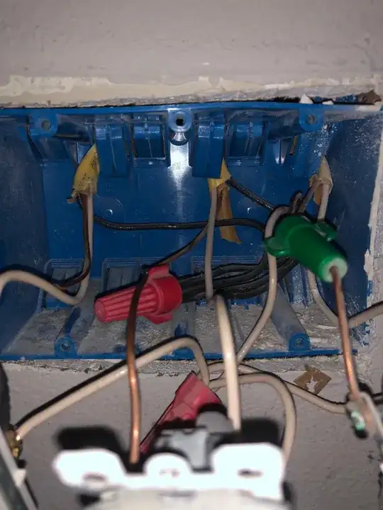

I am trying to upgrade my rocker switches to Smart Switches and ran into a problem identifying wires behind the old switches.
It seems that the old switch is connected with a ground and 2 white wires. There is a bundle of black wires capped and sitting inside the box. Everything I've read and have been told is that Neutrals are usually white and Blacks are hot.
What is going on with my wiring and are my hot and neutral colors just reversed? Or is the neutral connected to the switch and the hot capped? Or is there something else weird going on?
Thank you so much in advanced!
Here is a photo of another box. I checked a few of them and they all seem to have the whites running to the switch and the blacks capped and left alone. Still perplexed. I will trace back the wires but could it be that they reversed all of the wire colors in the home?

Your light switches are electrically upside down and backwards
Whoever wired your house clearly hadn't read, or decided to utterly ignore, NEC 404.2(B):
(B) Grounded Conductors. Switches or circuit breakers shall not disconnect the grounded conductor of a circuit.
As a result, you (or a friendly electrician, if you don't feel comfortable taking on a job this repetitive/long-winded yourself) need to switch things around so that the switches in your house have one screw pigtailed to the incoming always-hot black wire and the other screw connected to an outgoing black wire, with the white neutral wires all nutted together in the box, and the grounds all nutted together and pigtailed to all the switches. (If you run into a switch with more than 2 non-bare wires hooked to it, or with a white and a non-white/non-bare wire connected to it, stop and either consult an electrician or post a further question here, as that's a sign you either have a multi-way switch or a switch loop in play, which complicates things.)
What are the consequences?
While switching the neutral seems to work, as you have noticed by the fact all your lights seem to work fine, it's prohibited by the NEC due to the hazard it poses to clumsy lightbulb changers. You see, on an Edison (screw) base lamp socket, the "button" in the base is connected to the hot, and the screw-shell is connected to the neutral. This way, you won't get "bit" if you are trying to unscrew a bulb and accidentally make contact with the threaded metal part as you are doing so. However, it's possible for a bulb to bottom out in the socket with threads still exposed, so if you grab the bulb and get a finger on the threaded metal part, it's possible to get zapped through the bulb. Normally, this is only a hazard if the switch is on, and changing lightbulbs with the light switch on is a problem for several reasons, so it's normal common sense that one turns the light off before changing the bulb, no?
Well....bzzt! The wiring error in your house, with the neutrals to your lights switched, defeats that precaution, leaving the lightbulb and socket "live" and capable of shocking you, despite the switch being off! This is why switching the neutral has been prohibited by NEC 404.2(A) and (B) since the 1920s(!): it poses a clear shock hazard to anyone trying to use the switch as a disconnecting means to safely service a light fixture, or worse yet, a wired-in switched appliance!

The way a box like the first one can be decoded is using a multimeter; find whichever cable feeds the most switches with one of its wires, then take voltage measurements across all the wires in the cable. In a /2 cable like the OP's, one wire will measure ~120VAC to the other wires: this is the hot. We can then presume that the bare/green wire is a ground, and assume the other insulated wire is the neutral; checking to see if a ground actually is grounded is harder to do, though.

    `...the grounds (which are thankfully fine) left alone` Are they? They sure don't look fine to me. Each branch has its ground tied only to its respective switch - those grounds need to be tied together or there's no ground continuity in the electrical system. With a plastic box it doesn't even happen badly by accident. – J... Dec 19 '19 at 19:41

I would suggest you fix the switching problem with existing switches to verify function before retrofitting to smart switches.
You will need to get a tester and verify the black coming in the lower right corner is hot. If it is then take connections off all the switches, and connect all the whites together, connect the blacks leaving out the top as switchlegs (load connections), then pigtail that hot black to the line side of switches.
If you find the white coming in the bottom is hot then I would suggest it is time to call a seasoned professional to carefully correct the issues.

  • My house is also fairly new, built in 2003, and everything has been working fine up to this point. Another thing is I have a light figure in the bedroom that has electric wiring that goes to it. Not sure if that matters but a friend said something about a 2 wire switch and them running the neutral to the light fixture? Not sure what that means exactly though – Tony Dec 19 '19 at 00:06
  • If switch box we are looking at was switch looped like your friend described then the black and white pairs from each cable would attach to the same switch, and you wouldn't need a fourth cable entering the box. – NoSparksPlease Dec 19 '19 at 00:13
  • It could also just be a switched hot . In that case the white wire should have been taped black. – JACK Dec 19 '19 at 00:19
  • Further more, I tested the voltage switches in the first photo. The top white wire is getting 110v. When I uncap the black to test it, it measures low and jumps around from 0-5v. Now with the blacks uncapped, the tried testing the top white again and it doesn't measure anything. Test between the black and top white does not measure anything as well. – Tony Dec 19 '19 at 01:52
  • If it is a switched neutral then with the switch off you have an open circuit, you will measure open circuit line voltage through the light. If you flip the switch "on" you will complete the circuit, and voltage at the switch will drop to zero. – NoSparksPlease Dec 19 '19 at 02:02
    The decisive test is to measure the black from the bottom set, measure black to bare, if it is hot then you can visually trace the hot feed to the lights unswitched, and the white (the neutral) is switched. – NoSparksPlease Dec 19 '19 at 02:07
  • Really appreciate the help @nosparks. So the uncapped black and white. ONLY the wire that comes up from the bottom right corner of the box tested 120v (green to black, and white to black) Green to white didn't measure. Could you further explain the tracing of the hot feed to lights unswitched and white switched? I'm not positive I understand that part. – Tony Dec 19 '19 at 02:34
    @Tony first connect all the copper grounds wires together. Then with none of the other wires connected, test each one to a ground wire. If still the only one that reads non-zero is the black from the bottom you are in good shape. ideally should should check light fixutures and make sure inside them the backs are connected to blacks and whites to whites. I expect you will find they are probably fine, and the person who wired this house was just confused and thought switches be in the neutral path instead of the hot. – Kevin Cathcart Dec 19 '19 at 15:47
    Equally concerning though is the grounding wires. All grounding wires in a box must be connected to each other. And all switches/ outlets must have their ground connectors connected as well. I suspect this is a widespread problem. Ideally you should check every junction box for this, but at the very minimum check all of them with more than one switch/outlet. – Kevin Cathcart Dec 19 '19 at 15:51
    However, for this box in particular: leave the coopers connected, but add a pigtail to each switch. Connect all whites together. connect the thee top blacks to one switch each (load side if the switch specifies one). Connect the bottom black to each switch with a pigtail. Once you have done that, you would then be in great shape to swap these out for smart switches. – Kevin Cathcart Dec 19 '19 at 15:53
    @Tony Test between uncapped black and uncapped white. Then test uncapped black to ground wire going into green wire nut, and then uncapped white to ground wire going into green wire nut. – JACK Dec 19 '19 at 02:07
  • @jack thanks so much for your help, really appreciate this. So the uncapped black and white. ONLY the wire that comes up from the bottom right corner of the box tested 120v (green to black, and white to black) Green to white didn't measure. The rest of the wires didn't measure anything. – Tony Dec 19 '19 at 02:20
    @Tony based on those reading, black is the hot, and you're switching neutrals. The color codes are not reversed. – JACK Dec 19 '19 at 02:41
