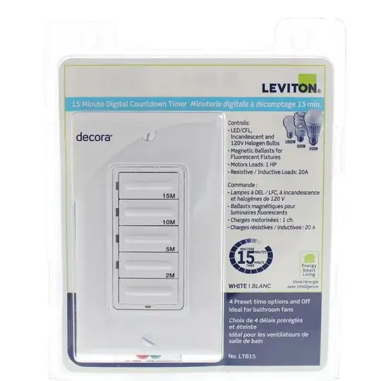

Now I want to add a minuter switch to the fan and the minuter have all these colors: black, white, green, red and yellow.
It a Leviton.
As I understand, black is for hot wire, white is the neutral, green the ground and red is for the line feed. Yellow is not used in this case.

The answer is the whole house must be searched for similar defects, including inside the panel, and of it must be fixed before you can even consider using a smart switch. For one thing, this incorrect layout is dangerous and can kill you.
But the smart switches also care about "polarity" and will not play nice with this wiring scheme.
