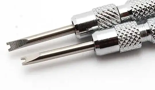

I recently found out the local name for a head like that translates to slotted flat. The screwdriver fitting those heads is an H-screwdriver. Look like this:
H-screwdrivers
However, for the smaller screws (with heads up to 5-6mm), it's common to simply take an old flathead screwdriver and a hacksaw. Might take a couple of minutes, but they can be made yourself quite easily. The bigger the pin in the middle of the bolthead, the more work you have with the hacksaw. On the really big ones, pliers could work but I wouldn't recommend it.
I don't see those boltheads as often as I used to (say 10-15 years ago), I think manufacturers prefer Torx nowadays in places where I used to see slotted flats.
