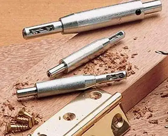

As you are a perfectionist for installing hinge screws perfectly it turns out that there is a product made just for this purpose. It is a self centering pilot drill that aims the pilot drill bit right on center in the hinge hole.
There is a spring loaded sleeve around the drill bit that pushes back as the bit bores the hole. The tip of the sleeve centers in the counter sink of the hinge hole.
These are often sold in sets for the range of hinge screw sizes that you are likely to encounter.

  • What would happen if you attempt to drill the pilot at a slight angle and not perfectly perpendicular to the surface? – Aleks G Feb 18 '20 at 16:07
    If you drill at an angle, even if the starting point of the pilot hole is centered in the hinge hole, the screw will also go in at an angle. The result will be a screw head that is not flat with the hinge face. Keep in mind that when using a self centering drill bit that it is much easier keep the drill positioned so as to keep the drill bit perpendicular with the hinge. – Michael Karas Feb 18 '20 at 16:56

    The tapers don't look like they'll self-cenre in the countersunk holes in the hinge. Also it appears quite easy to start them at an angle, thus defeating the objective. What have I missed? – Tim Feb 19 '20 at 08:02
  • @Tim - Your comment about the tapers on the tip of the tool is incorrect. These "VIX" brand self centering bits are recognized as some of the best made. Your comment may apply to many of the cheap imitations you can find via online retailers. As far as drilling at an angle, that can happen with any hand held drilling tool. What I can tell you is that it is easier to focus on keeping the drill perpendicular with the hinge face with a bit like this when centering is taken care of. – Michael Karas Feb 19 '20 at 11:15
  • I'm only going by the look of them in the pic. Those tapers don't look the same angle as the countersinks. In which case, they'll be pretty useless! But looking more closely, I was checking the *wrong* taper!! Not the one on the end... Sorry! – Tim Feb 19 '20 at 12:02
