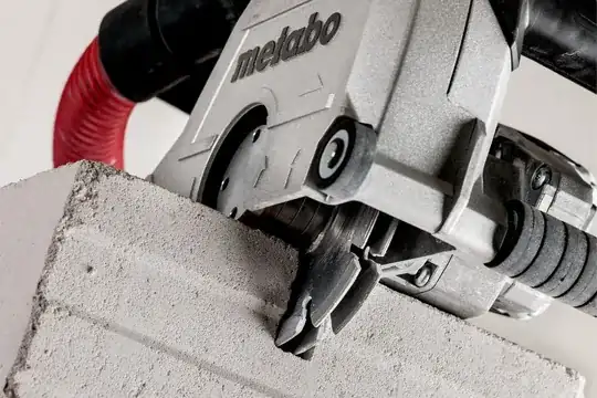

What is typical in Germany, where most walls are block and plaster, is that grooves are cut into the plaster, conduit laid into the grooves, and then the whole thing gets covered with plaster again. There are specific tools for this called wall chasers, they have a set of blades kind of like a dado set that let you cut a groove into the plaster. This would obviously be more work and much more messy than the first option. In addition to cutting the channel for the conduit, you would of course also need to chisel out holes for the boxes that would probably go through both the plaster and partially into the brick. As Harper points out, in the US, it is probably required by code to use conduit, and either way, it would be common sense to do so for protection of the cable, as well as future replacement.

    I agree, I have decided that having the right tool for the job is basically always worth the money, it saves so much aggravation. Finding the right tool is sometimes a challenge though. – PhilippNagel Mar 04 '20 at 15:24

The standard method is to chase down into the brick & plaster - either old-style with a hammer & chisel, using a channel-cutter as mentioned by PhilippNagel, or more commonly using an SDS drill set to hammer only & using a large chisel/spade bit.

    Can also use an angle-grinder as the first part of chasing - cut two parallel lines then clear out with a hand chisel/SDS chisel. – MikeB Mar 05 '20 at 12:28
  • The difficulty here is that there is no guarantee that I will have power while doing this, and from what I can see there are no battery operated Chasers. I have Milwaukee M18 tools so I could get some chisels and a portable SDS drill but I'm wondering how difficult that is going to be. Have you done it before? I need to run about 16 channels, roughly 1 foot from the floor. – mreff555 Mar 05 '20 at 12:44
  • It's not something I've done a million times, but I have a good 24v battery-powered SDS & large spade chisel which I have on several occasions used for such a task. I actually live in a very old house with 'pre-modern' wiring standards, so every time I redecorate a room I have some of this to do to greater or lesser degree. The upside, as you're re-plastering anyway to bury the cables, is the channels don't have to be perfect. SDS is 'good enough'. & certainly easy enough. – Tetsujin Mar 05 '20 at 12:52
  • I just googled in the UK & you can get cordless wall chasers; to buy they are about the same price as a good SDS, 600 bucks-ish. They seem to all be 54v so won't have batteries interchangeable with most other tools. - one example https://www.tooled-up.com/dewalt-dcg200-54v-xr-flexvolt-cordless-wall-chaser/prod/478764/ – Tetsujin Mar 05 '20 at 13:07
  • @mreff555 I used to live in the UK and chased wiring by hand with a chisel & big hammer once or twice. With an SDS hammer & chisel you would be all set. Messy but very do-able. For short runs like 1' I think you're better off that way than with a grinder because of the dust. – StayOnTarget Mar 05 '20 at 16:51
